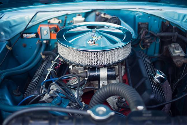

Another option is the PCV valve in the right bank cover with a rubber grommet and the hose running to the fitting on the carburetor base (visible under the coil), and a breather cap on the left bank cover.
Yes, thanks, I may just do this too. But,
How did you get that filler cap to fit snugly? I have one and it’s loose as heck??
Use a new/different gromment or cap. Buy them as a set and they should be tight. Local parts stores carry them.
Not positive, but now that you mention it, I think mine was loose as well. I just looked and the breather has two gaskets. One is a fiber type and then a rubber one on top of it. I think I may have added the rubber one from another old cap. It is nice and snug now. Should be an easy fix, as themechanic suggested above.
