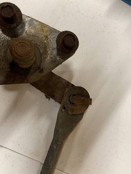

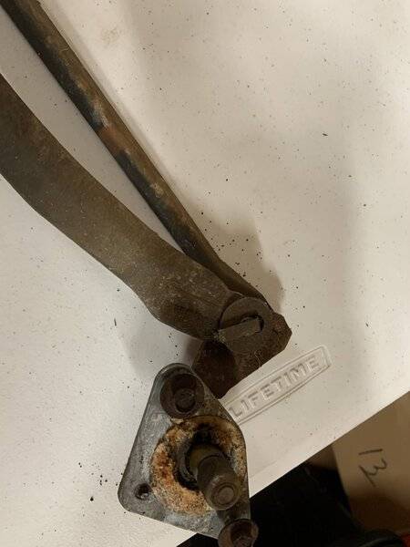

Or are you talking about the little clip on the drivers side arm? Like pictured?
I do not have an old clip that I need. When I pulled the plastic screen to begin removing the linkage I found the both arms just laying in the cowl. I guess the arms stopped working and a PO removed and either just left it all unhooked or began looking for the correct clips. My connecting arms have a round hole with a small slot. My auto parts guy did find a Dorman part that LOOKS correct but says for 1974 thru 86 Chryslers......so still not sure want is exactly needed.....thanks ....

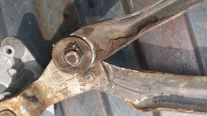

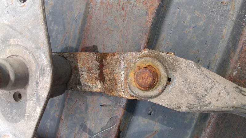

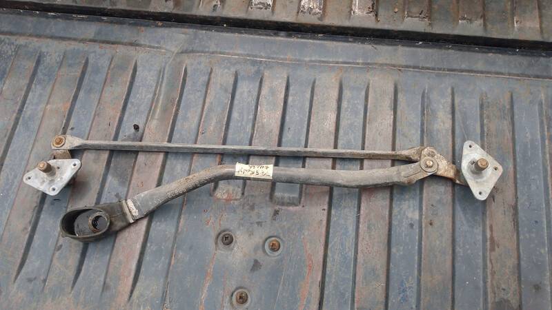

Well here's some pics of what I have. Removed from a 1973 B Body. Looks like "C" clips were used to secure the linkage arms to the pivot points. That is IF that's what you're talking about.

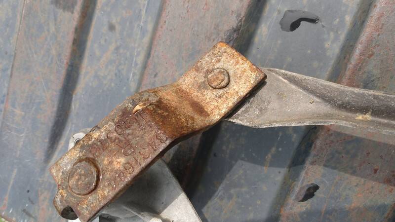

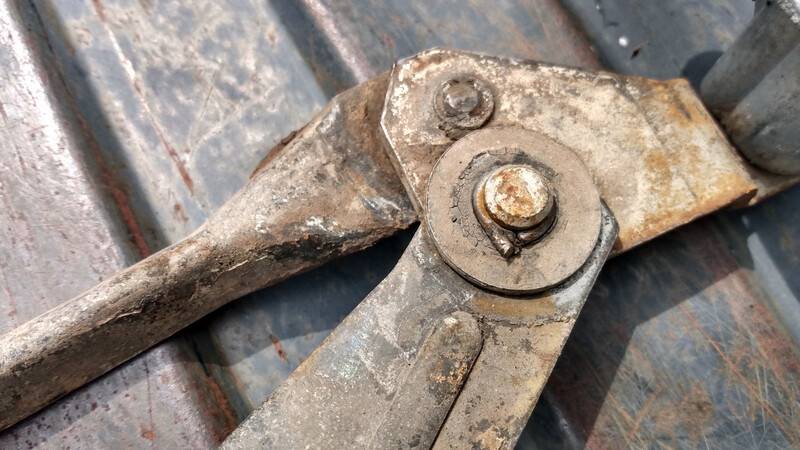

Someone messed with that linkage, they should be like these.
Thanks all for the info . I finally got to looking in my setup and found one partial plastic bushing still attached. I got the Dorman ,part # 49440, which states for 74 thru 88 Dodge/Chrysler and was able to squeeze them into the arms and then pop that onto the hub nubs. Feels kinda tight but is secure for sure. Now if I can just figure out which two of the four terminals to jump out , I wish to see if the two speed wiper motor is working the hubs/arms easily and correctly. I found NO evidence of metal C clips were used....but since all was laying in the cowl....not sure what was done prioer to me getting there....
Yeah, those are the ones I used on my old 74 Charger. Also on my 78 AND my 93 Dodge trucks. Wonder why the catalog just said up to 88? Anyway, I think the metal clips were used on earlier cars. I wonder if they lasted until 73?
