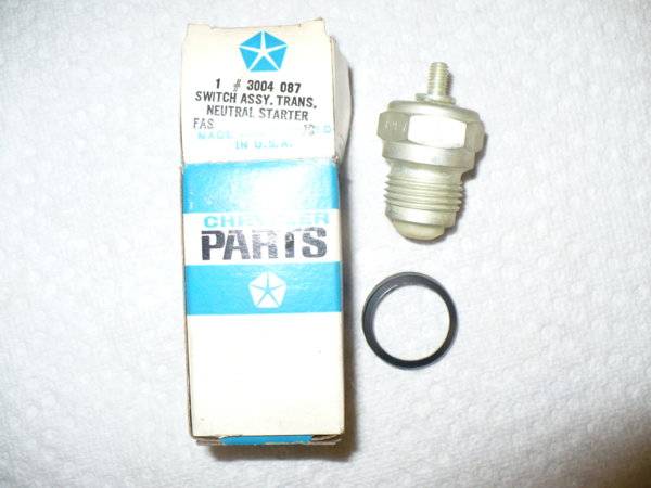

Ground the tab ON the relay that the wire to n/s is connected to. Be careful it will start in any gear if n/s is the problem.
N/S just unscrews and the trans fluid pisses on the floor if you don't put a pan under it. Been a while since I did one but probably you should have trans in any gear but neutral or park. Yours is a 3 pin? but note the gasket doesn't end up with two, make old one comes and not stuck to trans. I have to do before spring.
NSS is a good place to start. Word of caution, buy a Wells or BWD replacement, the standard motor parts seem to have a problem with leaking.
Easy test before you spend the money for a new nss.
You are looking for a ground on the brown/yellow tracer wire at the starter relay in park and neutral only. A volt/ohm meter or test light will do.
