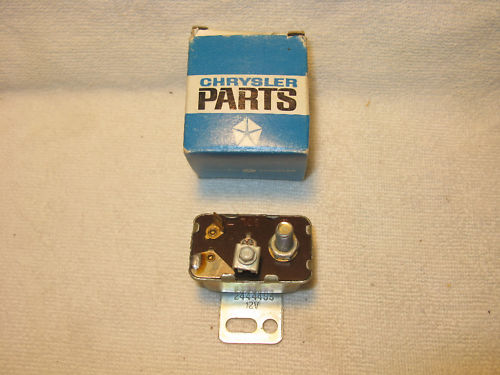

I have just converted my car from an auto to a 4 speed. How do I bypass the neutral safety switch?
Right now I have pulled it out of my auto and ground it to start it up? Not to convenient.
Standard transmision uses a different starter relay, it doesn't have the tab for the wire to the transmission. Just ground the wire until you can get a replacement.
I'm not sure about the earlier cars, but the 70+ cars had a switch on the clutch pedal that worked the ground on the relay. (Nice safety feature).
