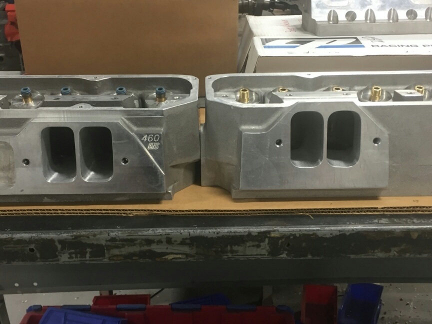

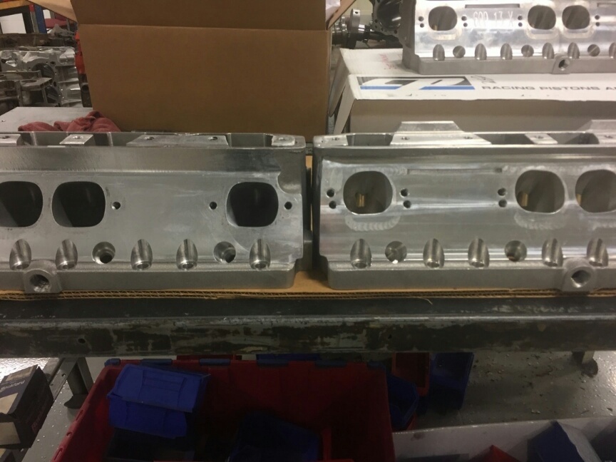

New Bjg Block wedge cylinder head this head is highest flowing mopar wedge that can support over 1300 HP, Need to thanks Mike Sanders, Todd Goodwin and Best machine We should have the new motor on the dyno in a month any interest call Goodwin Performance,Best machine, indy cylinder Head, Old cylinder head on the left new cylinder head on the right......

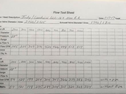

Impressive CFM/Flow #'s
really raised ports, both sides

Is this an INDY 600 13 that has been ported and or reworked or what.. let us know
.Thanks.
It is a 600-13 that has had the runner cores moved. Different casting. Todd Goodwin also has some outstanding big bore space Hemi stuff.
