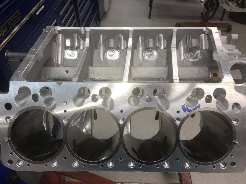

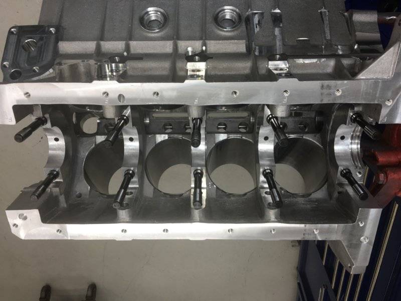

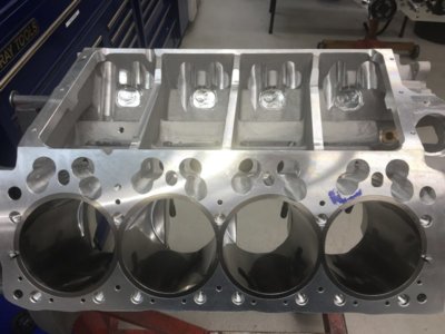

Here is a couple of pics of mine up at FHO....578 Hemi in the works.:thumbsup:

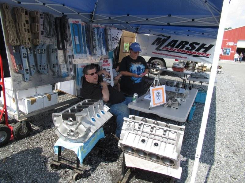

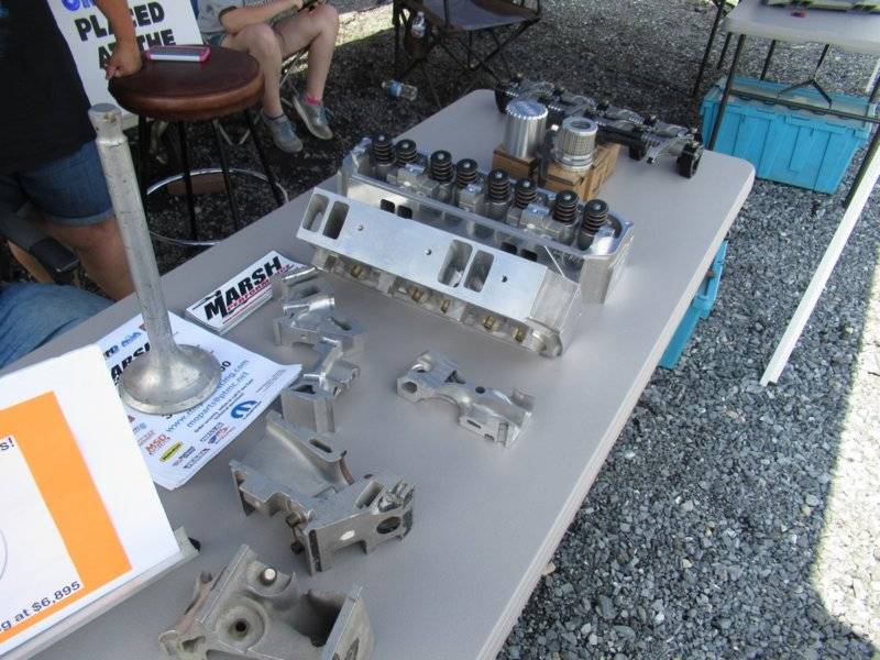

How long you guys been waiting to "have" yours?? Huge thread on another site about this subject.I saw and touched one at Carlisle while visiting with Todd.
