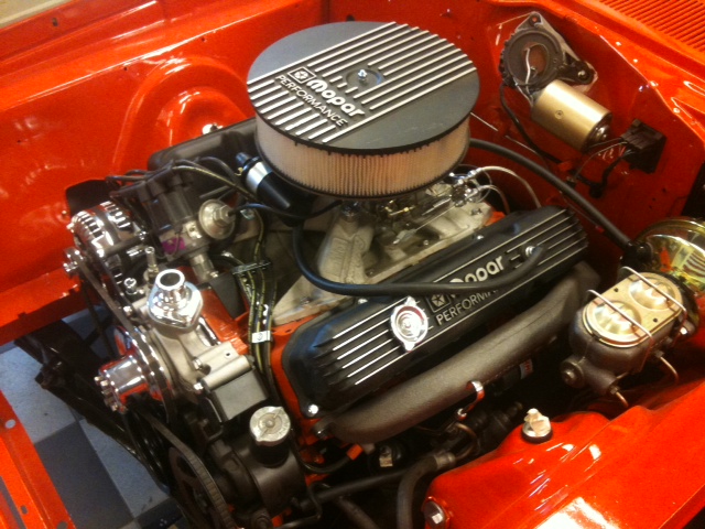

Yep, to make it look purrrdy. New 69 RR w/383 for me. The ext. re=paint is good, the interior is an 8+..... but the engine compartment was the pits. Removed the engine & tranny for a re-paint of the eng. compartment.... the engine has recently balanced and has excellent compression.... They just forgot to tidy up the the surroundings and I have detailed and painted the eng. and would like to replace the visible bolts with ARP polished stainless for looks.

Hey man, do I see a plug wire separator that's made of metal near the distributor? You may want to reconsider using something that's non metallic on that if it is....
