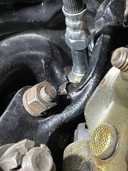

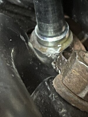

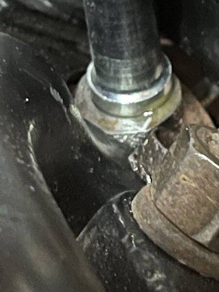

Ok, brake cylinders are not the issue.....but rather the front hoses that screw into the cylinders. Those things are pissing me off. They really dont like to seat.
Ok, so I get a pretty consistent leak from the front brake hoses
3191598C-B53D-4E2D-A300-3FFC5FA4365B.jpeg 773328BD-2ACD-46AC-BEF1-1CC47755765A.jpeg
Oh ****…., looks like no….both sides
That was it. Damn hoses from parts store had no seals ….and I must have forgot to check
