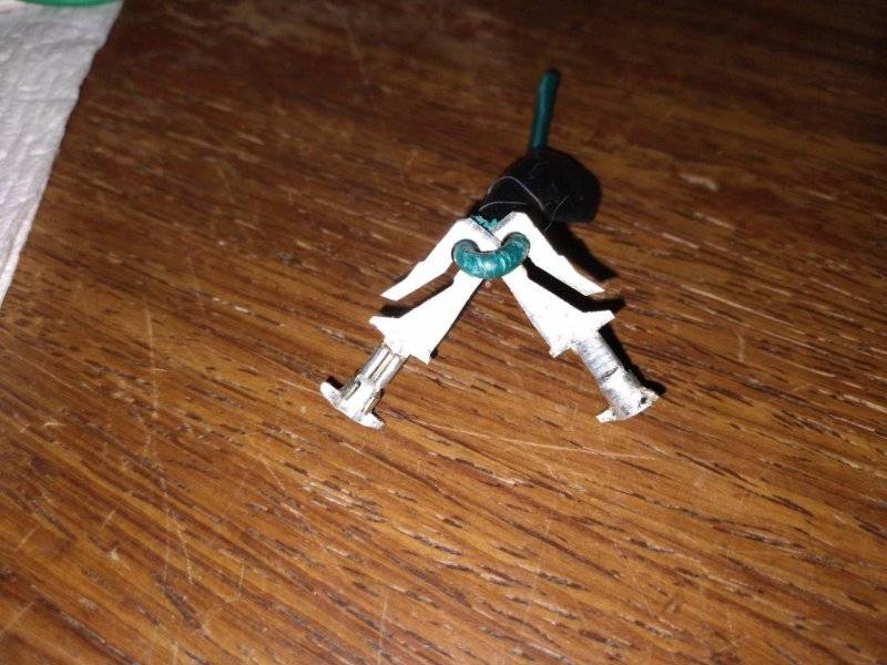

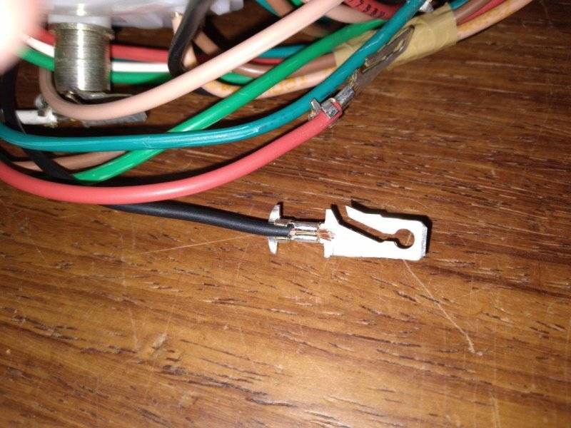

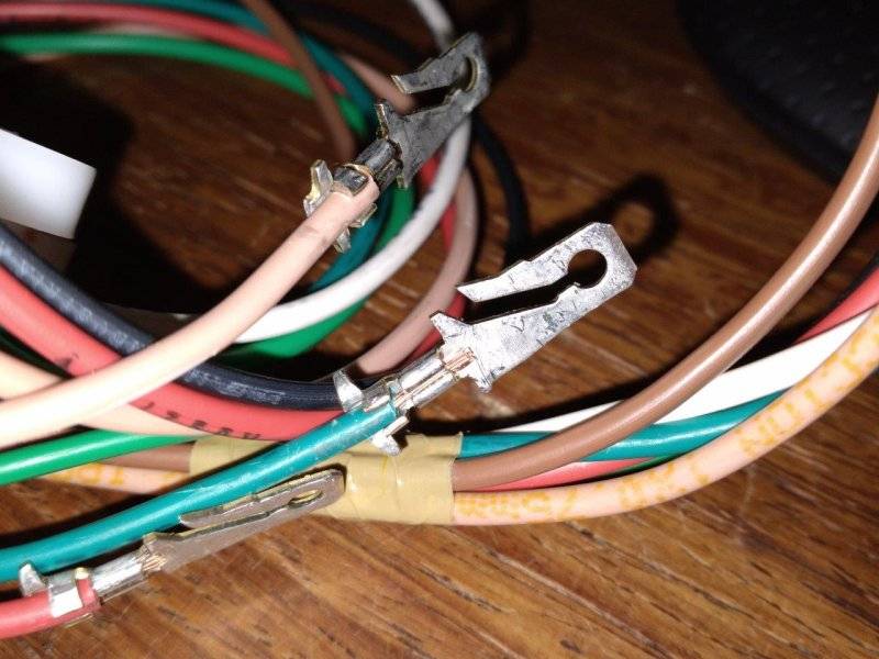

Just a heads up if you buy a new TS switch assembly. All the connectors were not properly crimped, see pics. Luckily I had a good open barrel crimper and extra blade style connectors. eBay auction Plymouth 1962-1963 Brand New Turn Signal Switch TS102E Replaces Mopar 2258700 | eBay . I let the seller know.
