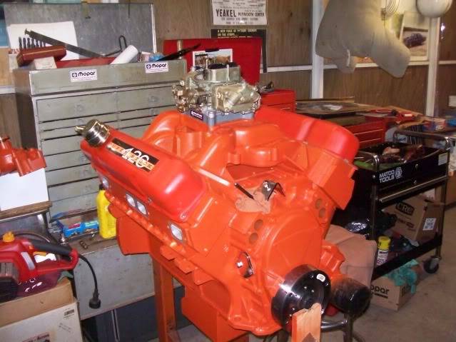

I have my new Indy EZ headed 493 just about done for my 63. Ron
Painted it today. Just need to get my waterpump and housing on and order my pushrods. Ron

She is done and ready to go in ! Ron
Hah - looks just like the old one. no one will ever suspect............

What kind of valve covers are those? I have 1.6 rockers and want to do what you did. Call me a copy cat or what ever. I was told that the stock covers wouldn't clear the rockers so I went with an aluminum set but not real keen on the looks.
Well done. As usual your car will look great. Interested to know what the performance difference will be from the old engine.
Thanks for the kind replies. The valve covers were an older set of chrome Eddy valve covers. They were on the original 383 in the car when I bought it. They were scratched up some and I wanted this Max Wedge look so I decided to paint them and see how they look. The plus is that they are taller then the stock covers and clear my 1.6 rockers and still give the Max Wedge look. I know they are not a perfect match with a stock Max Wedge valve cover but they let the roller rockers fit and give a close enough look for me.
