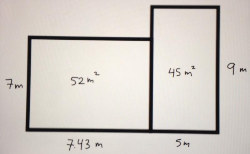

Only thing I would say is make sure you have maybe 9-10 meter depth (30 ft or so) so you have room to pull that 383 next winter when you decide it isn't enough motor. (I kid, I kid.) :) I would think your winters are so tough, no way you want to be pulling the car half out so you have the room.
Also, since you are square foot limited, maybe just make 1 bay 10 meters deep, keeping the rest a standard depth. This will maximize the width, which will maximize the number of cars that can fit; likely maximizing the resale value of the home.
Maybe something like this? This should provide room to walk around the lift plus room to pull a motor, while creating a more traditional 3 car garage floor plan.
Not to scale, lol.
Not to scale, lol.
That is awesome!
You have given me an idea...I gotta break out Sketchup..I'll post back...
