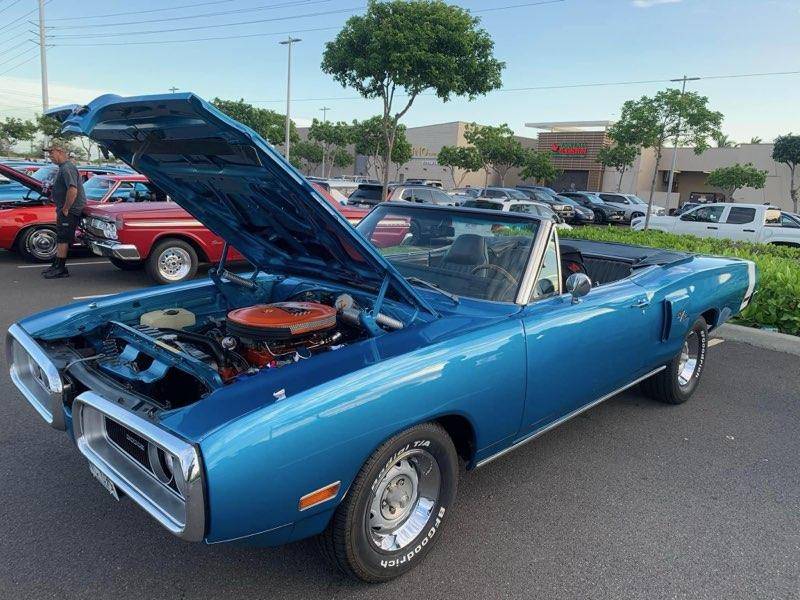

Welcome, from the middle of the Pacific ocean. I have a 70 Coronet too.

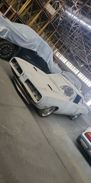

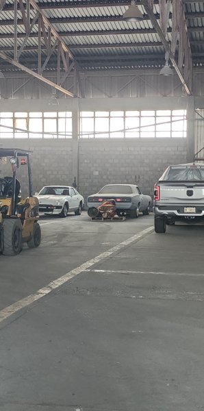

First of all I apologise for my English writing
My dream is to own on of these mopar muscle cars
First I start to search for chargers especially 1969 ones and o found some chargers and roadrunner with good prices after emailing then they were scams
Last Jan I found 2 coronets was on ebay for bidding one was all original and the one I owned now
I won the bid in this one after that I call some one who used to bring cars to kuwait and he call the owner which I annoyed him from lot of questions , the reason why I pick this car specifically because I haven't seen one here where I love and I think its rare to see coronets every where especially RT and it has a performance engine and I love these cars if it's fast
Alot of thought but I can not explain it in English , its like dream came true
