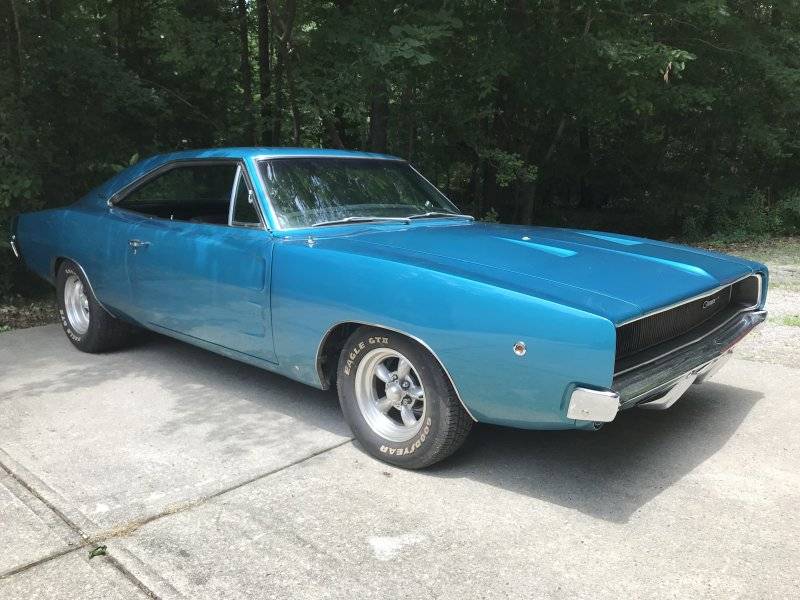

just joined up although i have been lurking on this site for a long time. it has been an outstanding source of help and info. i have a 1968 charger that i am starting an engine rebuild/swap project on. been trying to decide to rebuild 383 maybe stroke it or go 6.4 gen3 hemi. ah decisions, decisions.

Beautiful looking Charger. Good luck with the engine rebuild/swap.
That 383 sure can take a lot of abuse. I don’t hear many stories of them blowing up. My vote is the 383.

Welcome and nice looking '68, by the way.
Welcome from Illinois!! Great looking Charger! Stroke, Stroke, Stroke . . .

nice Charger,
Just build the 383, if you just want like 500+ HP
can be easily done if not an all out/or a race motor,
if you don't need every last hp
be just fine, be very respectable too
good rods & good balance, a couple thousand dollars in a decent stroker kit
crank rods bearings pistons rings :blah: all specific for that build
like a basic beginers stroker/entry level but very capable
