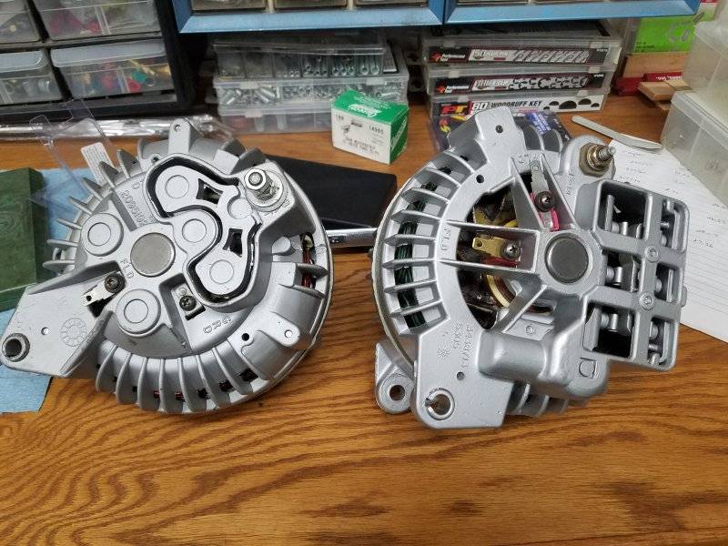

Maybe we are talking about 2 different things? On the left is what I call a round back single field 1969 and older. On the right is a square back dual field that I thought started in 70. This one is my spare and dated 1971, but I believe the one on my Duster is a 1970.
Nope, that's them... I don't recall seeing that squareback until 72- later ( again, I think the 70 & 71 uses a dual-field round ).
