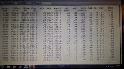

Hit a few bumps along the way, but it's finally where I need it to be:) These are the dyno results naturally aspirated using a tunnel ram with a couple of Dominators. The motor is built for spray and set up for it, but we ran out of time and energy.....LOL!

Dosent look like you need any spray with those numbers!

653ci, Indy block, Indy 600-13 heads heavily hand ported, Jesel belt drive and Jesel rockers, big cam;) crank 5in stroke, steel rods, Ross pistons, yada yada yada......... Wilson sheet metal tunnel ram is plumbed for nitrous and has 2 dominators, also have single 4bbl deal. Dyno'd at 1050hp with the 4bbl.
