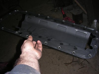

I had a thread not to long ago asking about what the best pan gasket was since I had an annoying leak to fix and took the advice of upgrading to a windage tray while I was at it. Anyways here it is, I've put a couple hundred miles on it without a drop (I did add a little RTV at the timing chain cover and rear main transitions for insurance). It's supposedly reusable and looked to be a quality piece so I just figured I'd share the results.

I'm considering one of these windage trays as I try to fix a leak in my 440. I have a stock type oil pan (but deeper sump). I noticed Jeg's says theirs is for "smooth pan rails." Summit's appears identical, but makes no mention of the pan. Anybody using these with a stock-type pan with the dimples in the flange? Curious if this tray will still seal with the dimples. My 727 has a similar type seal, but it was for cast aluminum pans with a smooth flange.

I filled my dimples with jb weld and sanded smooth before installing, and all is good.

I am using this with a stock pan and have no leaks since I went to this over a year ago. I also used a few dads of RTV at the timing cover and rear seal. I guess if you were nervous on using this on a stock pan why couldn't you fill just the dimples with RTV and squeegee the excess so the dimples are filled to the rail height.
I bought the one from Jegs. It sealed up great, but when I had to remove it, the sealing ribs on it seemed to have warped. Some of them tore. I put the old style windage tray back on.
I installed one of these (with help) this weekend. The Summit variety- it looked nice. Fit well. We used some sealer where the timing cover and rear main seal retainer meet the block flange. We also filled the dimples in the pan rail with steel-reinforced epoxy, sanded flat. Everything went together easily. I'll update regarding sealing once the car is entirely together and driving again (numerous other issues also being fixed).

I'm happy but did find a downside, if applying RTV in areas of concern it will pull the rubber seal off of the tray when removing it. I just put more RTV on it lol.

I found the bolt holes off slightly so it's best to leave it loose until all of the bolts are in.
I did fill the oil pan dimples with black rtv as one of the embossed sealing lines do run along them. I let it dry for 24 hours before installing the tray. Thankfully the rear of the tray is notched to clear my arp main studs which protrude slightly.
