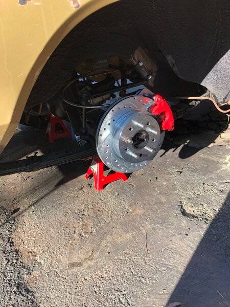

68’ Coronet 440 with Right Stuff 4 wheel disk conversion. We just got the car rolling and the right rear is giving me fits. All of the brakes work great but the right rear has a very low frequency groan while driving. Apply the brakes and it goes away so it is in the brake assembly. I thought maybe caliper grease was needed so I even swapped pads left to right to eliminate them and applied the grease. No change. Visually everything looks good and the caliper bracket appears square. I backed off the parking brake adjustment to take it out of the game also. A left hand turn putting pressure on that right rear makes it worse. My temp gauge says a pad is dragging as it is running hotter than the other side but I can’t figure it out. Any thoughts would be appreciated. The groan vibrates the entire right rear.

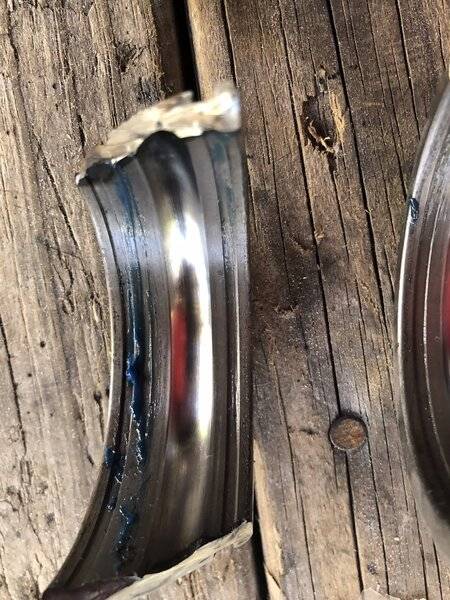

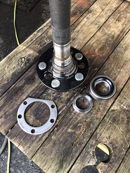

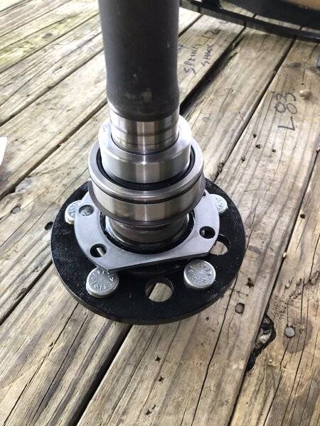

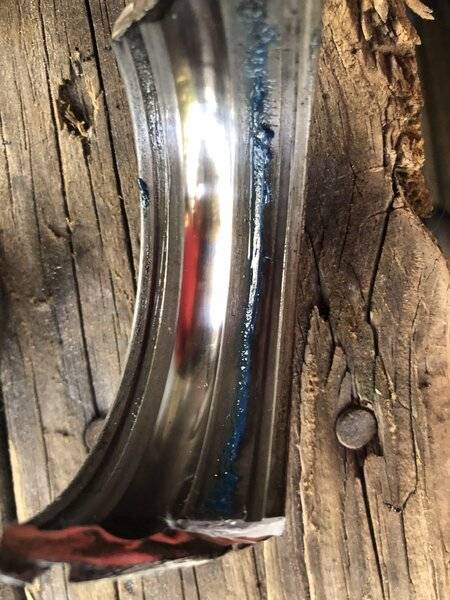

I could not take it. Summit Racing in McDonough had a green bearing in stock so I rode early and tore the axle out at lunch. No visible signs or rotating indicators but after replacing the bearing we appear back in order. The old races and balls looked good, but obviously there was a spot somewhere.
723C6856-4703-49F2-8373-8B95DACE3F61.jpeg E5E634B3-D5C8-4BDD-BA56-784FE29A83F9.jpeg
Did you remove the thrust buttons with the green bearing install. I see no mention of it.
