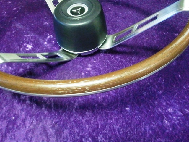

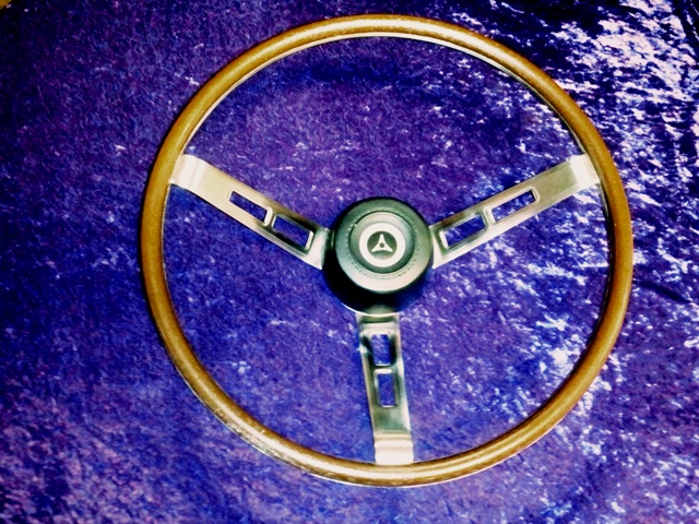

grant wheels seem to have a boss kit for every application, even the space shuttle.Go online to their site and check it out… HOWEVER……dont get caught like me..
I found a Grant 3 spoke mopar walnut rim, brushed stainless spokes, looked sweet, the website said fits standard colomn…. I assumed all 69 superbees where colomn shift auto or manual stick shift and therefore 'standard'…… Wrong bro.
Not enough dish on the wheel to clear not only the shifter but also the winker stalk…
The wheel looks great on display on the office wall…
Plumbeeper are sending me a new woodrim 3 spoke factory style like the Charger wheel…….. For xmas…. YAHOOO

Yeah, that's a pretty nice looking wheel and will look great on your car. You will need an installation kit and like Greg noted, it may need an extension kit to clear the dash and turn signal arm. They have those extensions on their site as well. You'll have to keep us updated with your progress and post some pics. Here's what Greg's wheel looks like...

was a merry christmas when new bits turn up….
and the government even got a backhander in duty.
Wheel looks great and feels right.
