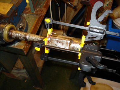

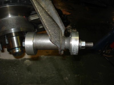

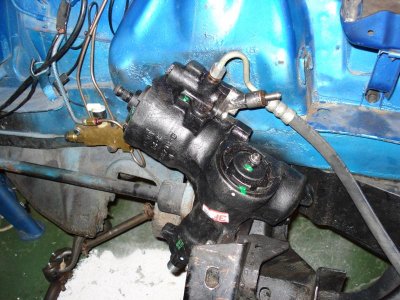

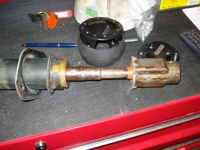

Short update. I went with a normal PS gearbox from rockauto because i wanted the smaler sectorshaft because that was the old box and the price ofcourse. . Got the new one and the sector was the big one but they sent along new pitmanarm for that. If i hade known that i had orderd the 89 policebox. I hade already bought the smal sectorshaft long pitmanarm so that wount fit now. New internals for the coupler and new hat for the end. Moog ofset bushings for the uper A-arm. All back in the car. Done this setup on my camaro 1967 and it felt fine. Not a racecar but nice daily driver.
An old friend of mine i havent seen for 15 years just bought a challanger r/t 1970 and is parting the garagespace with me. 2 dodge`s and 6 bmw. Mopar rules.
Fix on guys
as you see the renovation is going forward. Some steeringparts and moog bushing instalation with my home made tool.
