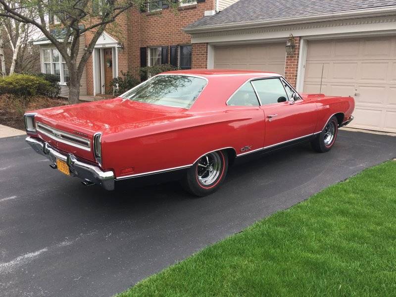

From my experience, you did the right thing by going with DiamondBack. I bought a set of Cokers for my 1967 R/T. Around 4000 miles, the cords separated on one of my front tires. I bought a pair of DiamondBacks to replace them, and still have Cokers on the rear. The Cokers all took gobs of weight to balance. The DiamondBacks were OK. Coker buys old BFG molds and make their own tires (they are not very good at it). DiamondBack has BFG make their tires with a blank face on one side, so they can apply their sidewall.
I've heard the horror stories about Cokers, but personally I've had good results with them. I ran their radial version of the Firestone red line (with bias ply tread pattern) on my '68 GTX which I drove to Carlisle for many years, five years until I sold the car, never had a problem. I put Coker Firestone bias plies on my current car, but it sees a lot less driving, and the radials were back ordered. I've run both 14" and 15" wheels. Current car I have an originality obsession, because I test drove it back when it was new. Maybe you want to have one set of each for your Charger, and the Diamondbacks have gotten good reviews consistently on this site.
