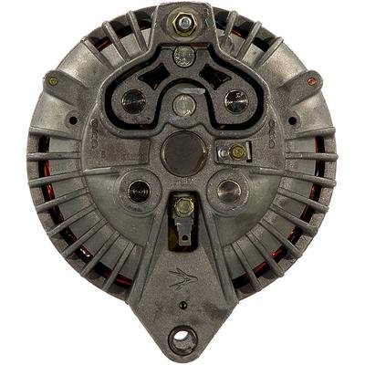

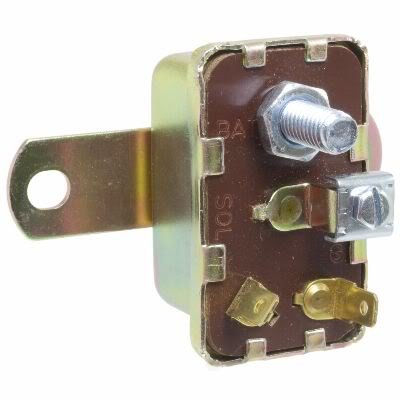

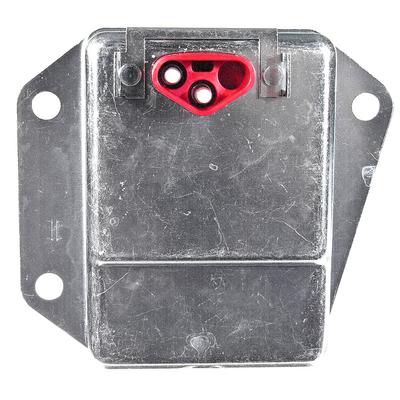

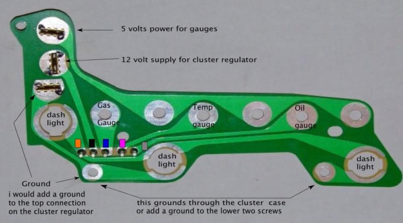

budnicks, i really appreciate all the help and tips, i dnt no how u knew bt all the pictures n diagrams seem 2 be everything im having problems with lol, i will definenlty take a closer look at them n trace all my wiring n grounds, and thank all of u for welcoming here 2 the forum
Tpodwdog, my car wasnt starting at first, bt like u said it was a bad ground 2 my starter relay, it starts now bt i have a lil problem with keeping my battery charged, it will stayed charged 4 like 3 weeks or so, ive traced my wiring n it all seem hooked up rite bt i have so may spliced wires from previous owners that now im just trying to sort them all out 2 find out which ones my car needs and doesnt, im honestly trying to find a new or used wiring kit just 2 redo it all cuz not all my wires match color wise 2 the wiring schematics
Common stuff
Your welcome "sorry, 1.5 months, kind of late", pretty common issues, I covered there...
