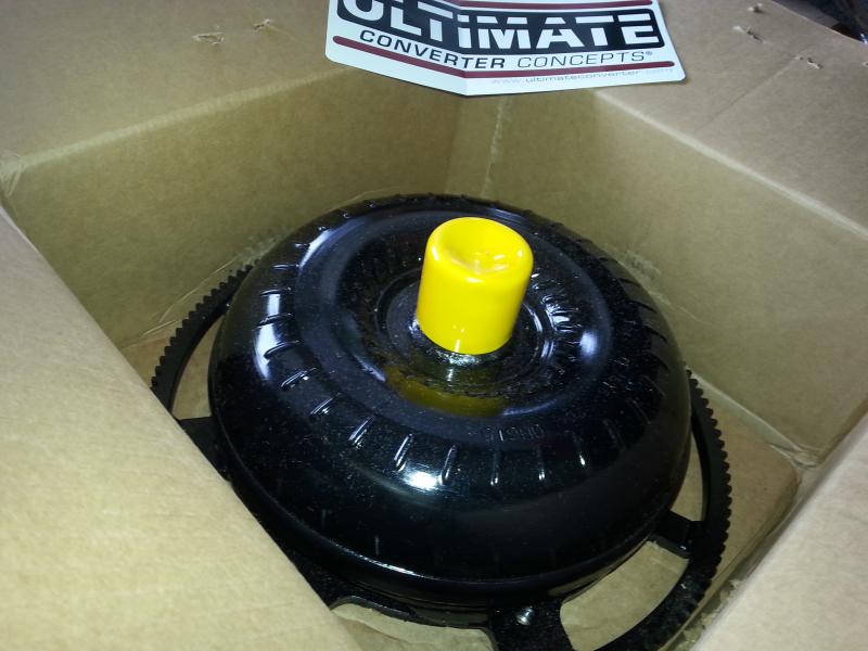

converter.jpgI have a 5200 flash converter and it drives just fine on the street. I don't drive it as a daily driver at all, but I do drive it into town to McDonalds, Orielly's and to local car shows ( in between the drag race weekends, lol )
