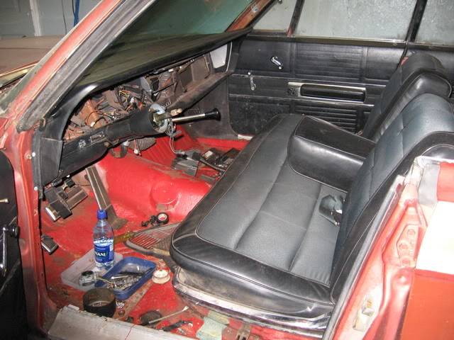

put an aftermarket switch in today and back to same problem, I have fully functional hazards but absolutely ZERO turn signals (Inside car or out). I changed all the fuses just to be safe and have now installed two serparate switches...what am I missing?
What would cause the hazards to work but not the turn signals? Rule out fuses and rule out the turn signal switch.....whats left
OK! I think I found the problem...went to www.mymopar.com and printed out the wiring diagrams for the 74 satellite/roadrunner. According to this wiring schematic there are TWO flashers...a hazard flasher with three wires going to it (Pink, red, and black) and a DIRECTIONAL Flasher with 2 wires going to it (Red and black). I found the hazard flasher and that is one that I have already changed and has the three wires going to it and the flasher itself has only 2 prongs. Which leads me to believe there is another flasher somewhere in this car.
Anyone with a '73-'74 satellite or roadrunner have any idea where this second flasher is located?
Also I need a new bracket for my radio, I just bent the hell out of it.
Thanks!
RonP, I give you props I ran downstairs, felt up under the dash between the ash tray and the glovebox and what do you know, theres the directional flasher. Popped in a new flasher and I have turn signals again !!!!!! If you ever come to Longview, Ill buy ya a case of your choice of brewski....just made my day.
LOL no problem. Glad to help.
