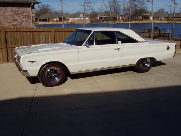

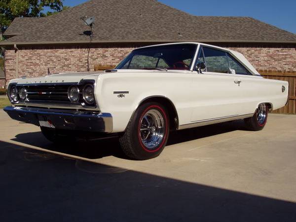

I went with 15 Magnums on my GTX. They do fill the wheel well a bit better. Their taller size will slightly raise your effective rear gearing however if that matters to you. Probably won't notice the difference. I think originals were 7.75 - 14 and the FR70 would be a little wider in cross section. A 75 series tire is probably the closest you will get in a modern tire to the originals unless you buy repro tires from Coker or somewhere. I'm about to replace my 215/75-15 redlines and I will probably stick with that size. I believe I installed 7 inch wide Magnums however and if doing again I would probably stick with 15 x 6 inch for a fairly stock look. The 7 inch wide ones with the bigger tires are very tight to get into the rear wheel wells when removing or installing.
Thanks for all the info, your car is stunning in white.
Definitely looks better in pictures.

The Magnums are 15x7 with a 4.25 inch backspace. The tires are Coker 215/75-15.
Mine are pretty tight getting on in the rear. I have to jack the rear up and let the axle hang all the way down - and still I have to fight them. I think the 15x6 Magnums would be better. Or, I think 15x7 Magnums can be had with a backspace up to 5 inch. The 15x6 that Coker sells has a 4 inch backspace.
