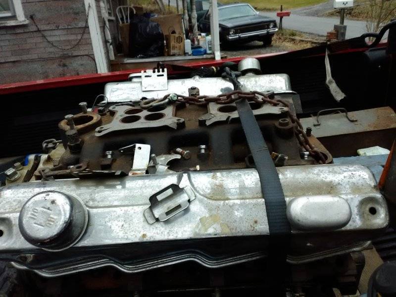

hay ... can you post a pic of your PS pump and brackets from the poly??
This is a random pic... it basically hangs off a ear on the water pump that newer model pumps don't have
