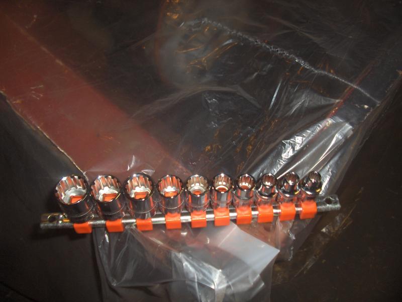

Sometimes I can get one of these Torx sockets on a rounded off nut. Saved me a few times.
