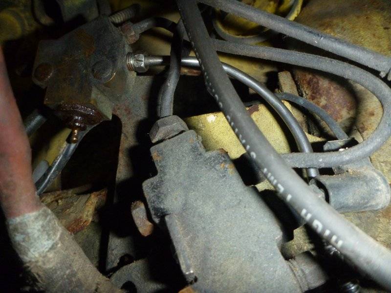

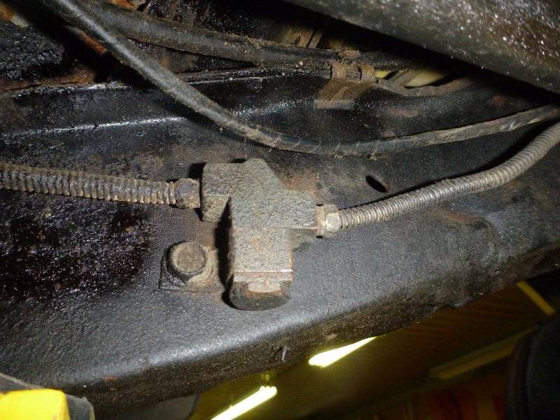

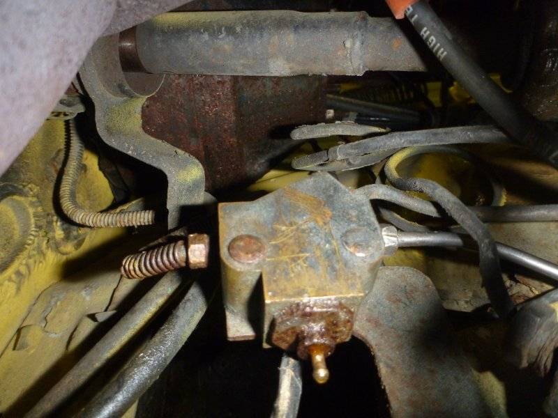

If it has the Hayes single piston, wide opening caliper, and the dual valve blocks + the differential valve further down the rail you need to get the fronts bleed and out tight and then have someone really stomp on the brake pedal and bleed them old school. You'll never suck it through...

You said you had the two "brass blocks" under the master. Just clarifying if this is what you have, as I show above, with the distribution block, metering valve and then the pressure differential valve further back on the drivers frame rail??? If so, get someone in the car pumping the pedal old school, like my Wife did for me. Hold to the floor and crack a bleeder, tighten bleeder and release... repeat as many times as it takes.. You also need the rear shoes out tight against the drum to do it right.
