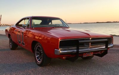

Thank you “shorthorse.”
Yes,... it is a 68 General Lee.
I am getting power thru the brake pedal switch (it is also a new switch) but .... I haven’t checked the lead going up to the turn signal switch (which is also brand new).
I have another “new” turn signal switch with the complete wiring harness going down the steering column. I haven’t install that yet,.... because I replaced just the turn signal switch by itself already.
Maybe I need to replace the complete switch with the new wiring harness???
I appreciate all the help. I’m new here to the forum & I just got the “General” a short time ago.
