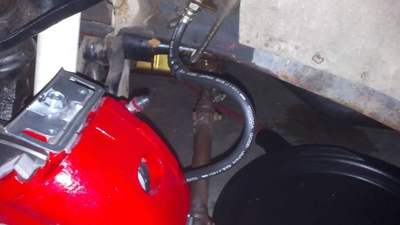

The break hose in the kit. I believe he said it was a 73 RR hose (don't quote me on that):
And there it be. Everything seems to be a good fit. Just gotta do the passenger side and change the master out:

nice looking and looks like a nice install thanks for sharing your text and photos :headbang::headbang:
Very nice!!!!!
I like the fact that you can identify what each component would be offered in factory options / vehicles.
