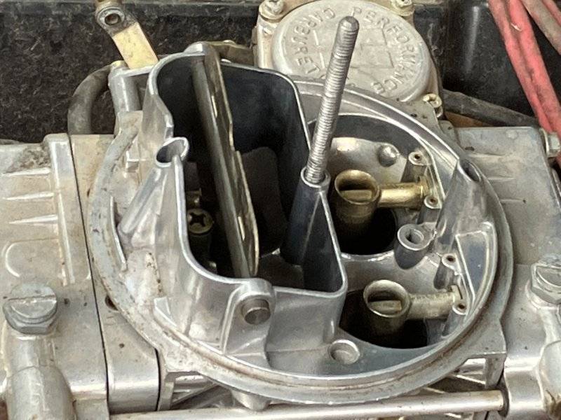

I didn’t see any mention of the carburetor you have but all carburetors have a vent. You can see the one on a Holley 600 just forward of the open choke plate.
You can pour fuel in there to fill the primary circuit enough to start the engine.

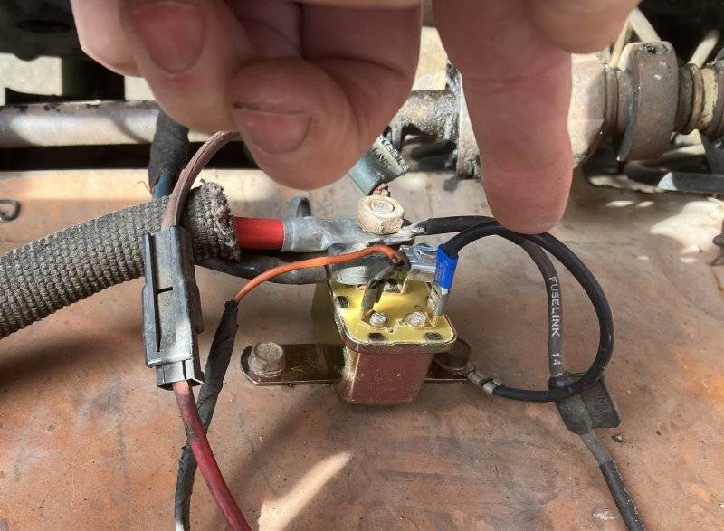

Regarding the no crank issue, you can temporarily ground the starter relay like so:
This will bypass the neutral safety switch.
Be sure you are in PARK or neutral!

Do like kern dog says, fill the float bowl and get it going. What carb do you have? Show a photo and we can tell you where to fill the carb.
Thanks man! I have an avs2 Edelbrock and a 750 holley double pumper…I was swapping back and forth some to see if I got any different results. The Edelbrock is what usually stays on it. I’ll take a picture tomorrow. I’m pretty sure from memory that I know the vent on the Holley.

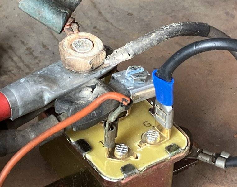

Another thing you can do instead of messing with wires to ground the starter - just jam a screwdriver blade between the bigger two terminals on the starter relay - the battery/starter feed on the big stud, and the next size down with the square washer under the screw. That saves messing with a key to start. If you try starting the engine like that, just turn the Ignition to ON first, making sure you're in Neutral or Park.
Yes...touch these two terminals with a screwdriver:
This will spin the starter over.
