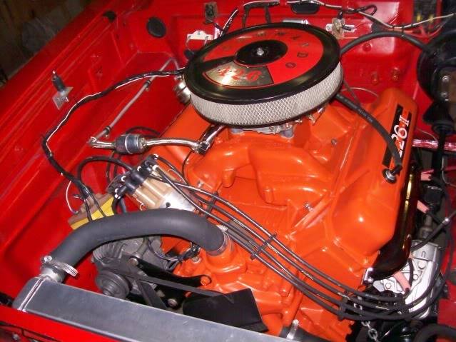

best way is to use a tube nut to an fitting to braided hose to carb imo thats what i did in my 63 plymouth.
