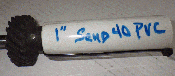

I'd start by rotating the crank to TDC on the #1 cylinder COMPRESSION stroke. Somehow mark the distributor to block location before removal. Note the position of the pump drive after pulling the distributor. The slot will likely be straight forward and back for "stock" components. You will want to put everything back in the location it comes from regardless of components.
A picture of a cheap shaft removal tool below. The zip tie just adds more interference for a tighter fit when tapped on. Your mileage may vary.
I made my primer shaft from a length of steel tube and a cut off 5/16" allen wrench pressed in and welded. You can also use a length of 5/16" hex stock if you can find it long enough. You'll spin the pump counter clockwise. Using a 1/2" variable speed reversible drill start off slowly and increase rpm gradually. You should feel the pump start loading the drill down if it's pumping oil.
