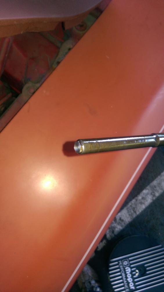

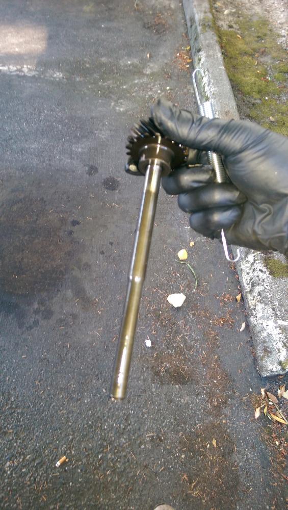

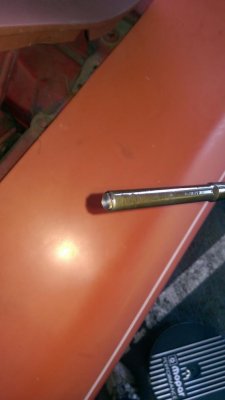

Well. Time for an update on this thread... I finally was able to troubleshoot, I pulled the intermediate shaft and sure as shot, it's sheared. SO, here's my next questions....is there any way to get the sheared portion out without dropping the oil pan and pulling the pump? My magnet tool wouldn't fit in there, any ideas? Or should I just go ahead and pull the oil pan? Could a seized pump or something along those lines have caused this?
I would not think twice about dropping the pan and installing a new oil pump. that's probably why it broke in the first place. I would dump the oil and filter for new stuff
hopefully , there is no other damage
That was my thought exactly, that perhaps the oil pump seized and caused the shaft to break. Okay, I'll go ahead and replace the pump and the shaft. Should I go with the high volume pump, since I'm replacing it anyway?
If it's a stock or mildly built motor there's no need or anything to be gained by using a high volume or high pressure pump. Your local NAPA store should have just what you need.
I wound up going with the high volume. It was the same price so i figured why not. It's only gonna help not hurt it if anything
