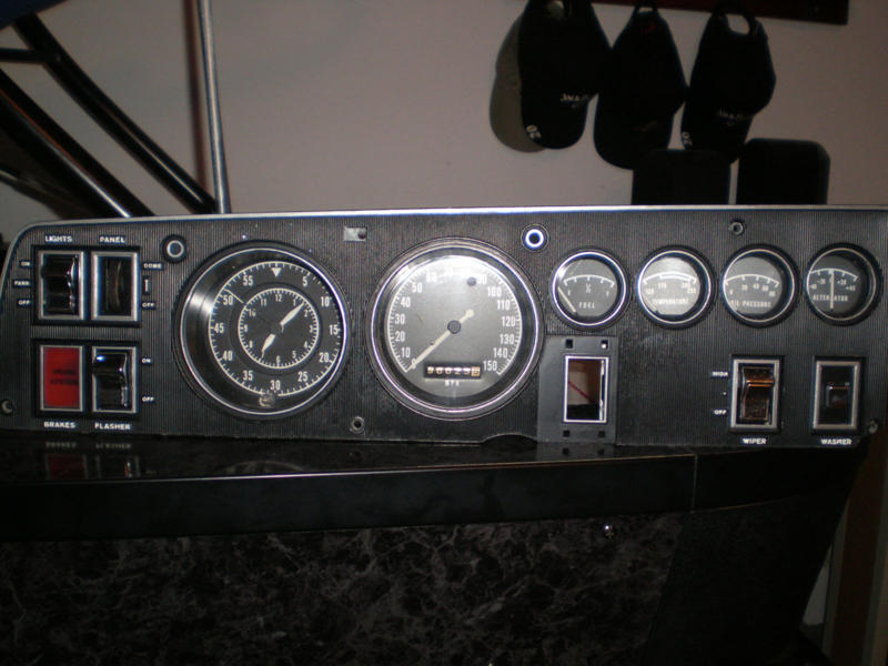

Yes I was installing a new Rally gauge that I bought years ago as the old one was no good but in doing so I lost the power I did have like the lights, key, and dome light. Also have a couple of wires that I found not hooked up so I am getting a color wiring diagram off of ebay if it covers the superbee and not just the normal coronet wiring. Here is a picture of the new "rebuild" rally guage

Nice looking gauges. Good luck getting this sorted out. Electrical problems usually are the most irritating to solve. But be persistant, you will get it going I am sure.
