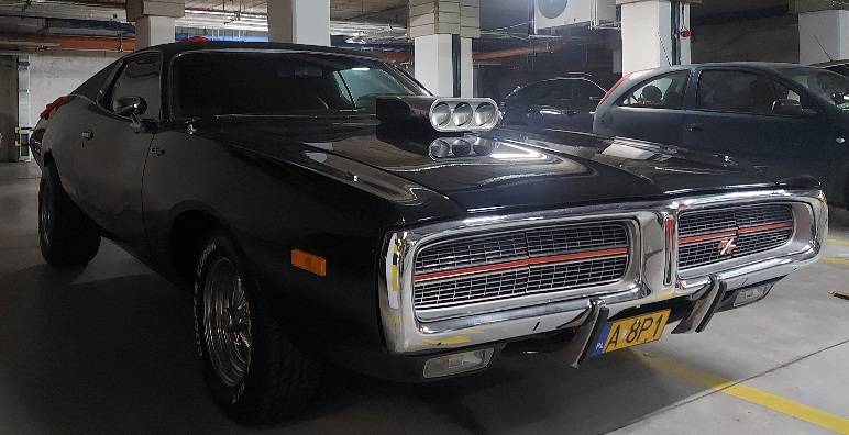

Guys, I have a problem with my Charger 72 SE 400. A few days ago I started it after almost half a year of parking it in the garage - I managed to start it on the third or fourth attempt. I left the engine to run for a while, turned it off and the plan was to drive it this morning. I open the car, none of the lights inside the car are on, I unscrewed the battery and charged it, although it looks like it wasn't flat. I screwed in the battery and no change, no power at all, not even the lights are on, not to mention starting the car. It's strange because I started it 4 days ago and everything worked. Can you advise where the problem might be?

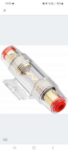

Thanks for your help. I checked the battery under load and it turned out to be okay. All the fuses were okay. Apart from one that was once installed right after leaving the positive polarisation, supposedly because there is a big amplifier in the trunk, but I don't know why it is around the entire circuit. It turned out that this fuse in the housing has no connection. I cut it out and connected it with a steel connector temporarily. The car drives and that's the most important thing :)
I would follow / trace that wire if the stereo is gone and see were it is going / ran in the car.
