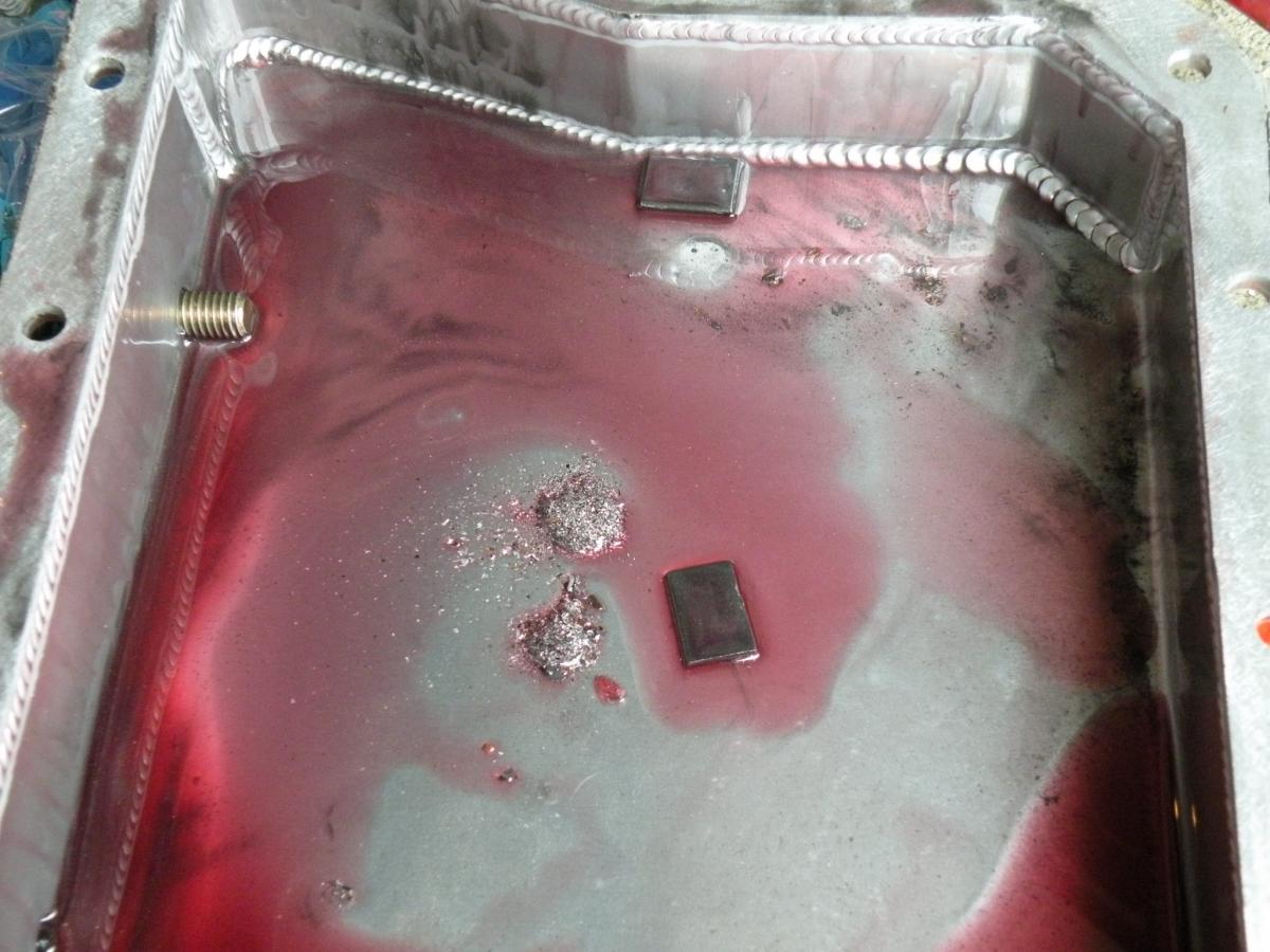

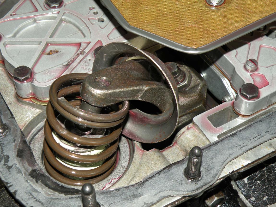

Here's whats going to hold me up from racing tomorrow.Check out pic. new tranny is in but still have to put on converter bolts. fluid,driveshaft. had to bring in my cuda. it is pouring here and strong winds.

Are those 2 pieces magnets in bottom of the pan or a 2 piece band strut?

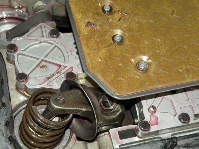

I think you'll need this:
Rear Low Reverse servo: I also make an improved rear servo assembly. My rear servo piston is a 1-piece design that replaces the stock piston, inner spring, piston plug, snap ring, and the after market shim used in performance rebuilds. The piston is CNC machined out of solid billet aluminum so it will not crack like the stock cast aluminum pistons are known for doing. It comes in a kit with a heavy duty stainless steel return spring that will eliminate 1-2 shift overlap, a new seal, and a .075 extra thick retainer made from stainless steel that will not bend around the retaining ring and pop out of the case like the factory steel retainers do. This kit fits 67 and newer 727, 518, 618, 46RH, and 46RE transmissions. I also have a kit that fits the early 62-66 727’s. The price for either rear kit is $75.00.
These parts are 100% MADE IN THE USA!!!
There is also a $8.00 shipping and handling charge per order.
If you have any questions, or would like to place an order, please email me at [email protected] Thanks!!!
You need this:
Thanks just ordered it today.looks like a great piece.
