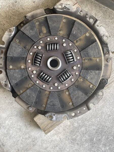

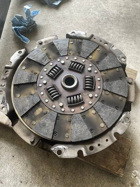

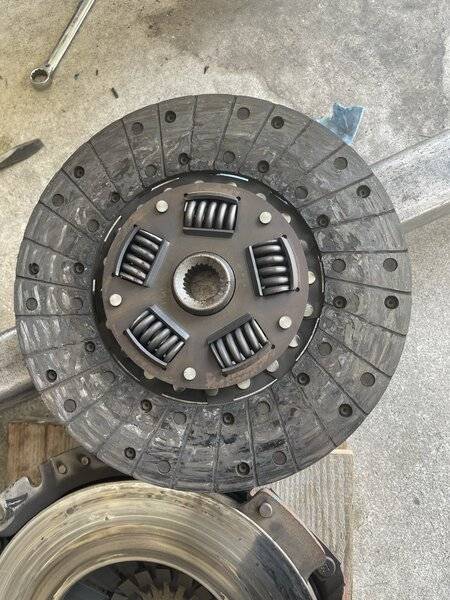

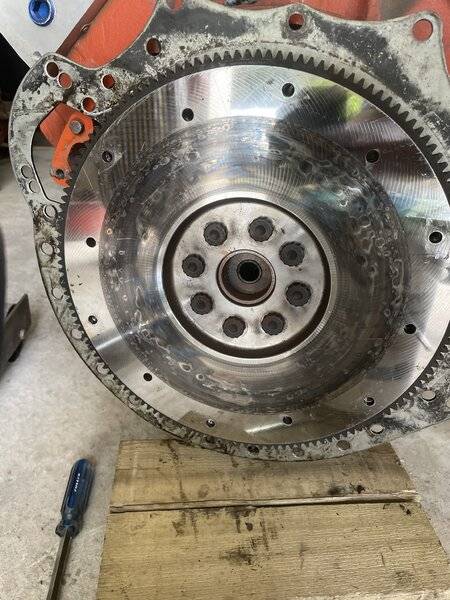

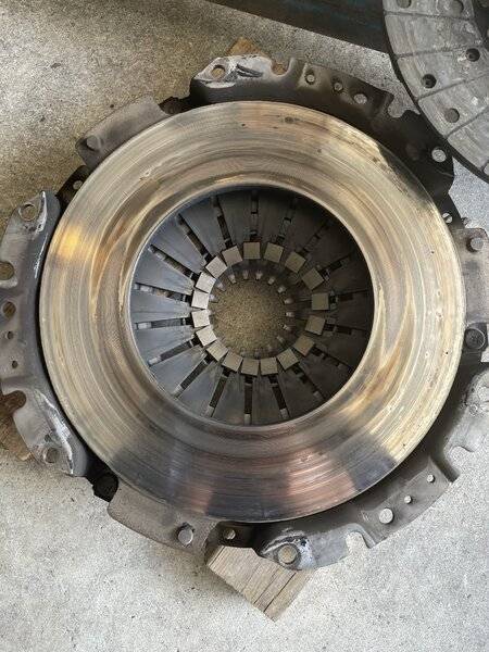

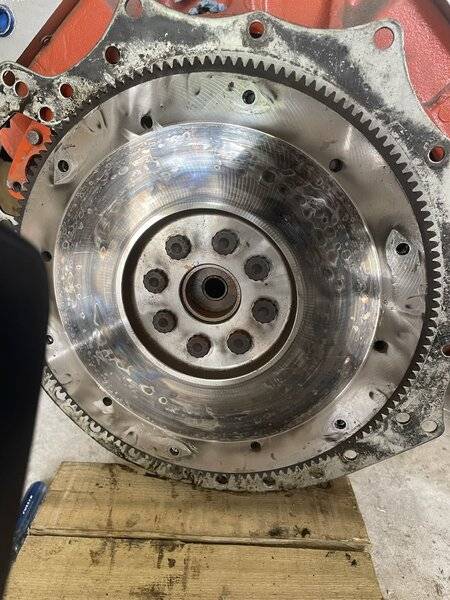

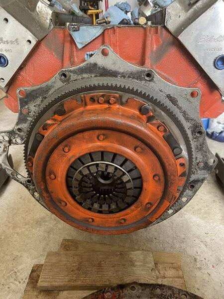

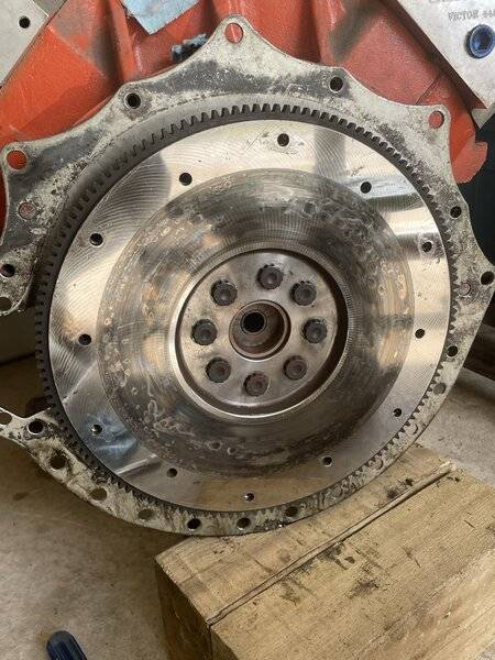

Hello again,
This is a new clutch/flywheel/PP from a few summers ago, I just pulled both engine and 4 spd yesterday. I don’t have any experience with what normal/abnormal wear and tear looks like, hence the pics. I’d love to hear what you guys see & think and thanks in advance.
Bob

I don’t see much in the way of heat spots or uneven appearance on the pressure plate and flywheel so I would guess it engaged smoothly. I would guess they are slightly glazed over. I would take some 80 or 120 grit on a sanding block and sand in orbital fashion around the surface of both and if they then look pretty uniform with no black heat spots or cracks, then reuse them. I suspect they will look just fine. I always install a new TO bearing anytime a clutch or transmission is out.
Looks like maybe a CenterForce Dual Friction unit?
Pressure plate wear pattern is a little concerning, least to me.

The heat scoring on the inner 3rd of the pressure plates' friction surface specifically; it appears for there not to be even
wear/temperatures across the entire face of the contact area with the clutch disc.
Might be considered "normal" for this setup, I dunno - but IMO it appears there's been some "riding" of the clutch upon take-off
from a stop or some such?
That surface should look fairly uniform across the entire contact area.
The flywheel looks to me like it's seen a LOT of heat.
8 bolt crank, lot's of power to go along with that?
Flywheel/ clutch shape may be a little more severe than I’m thinking/said. I would put a piece of 80 grit on an obital and go around both to clean them up and then see what they look like. if the clean up good then they should be OK. If there are dark spots and streaks remaining the the clutch is probably a goner and the flywheel will at least need a resurfacing.
