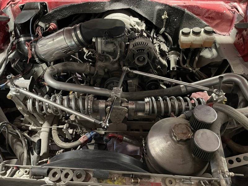

Looks like a fun project. Would love to see more info on 180 deg headers and suspension set up!

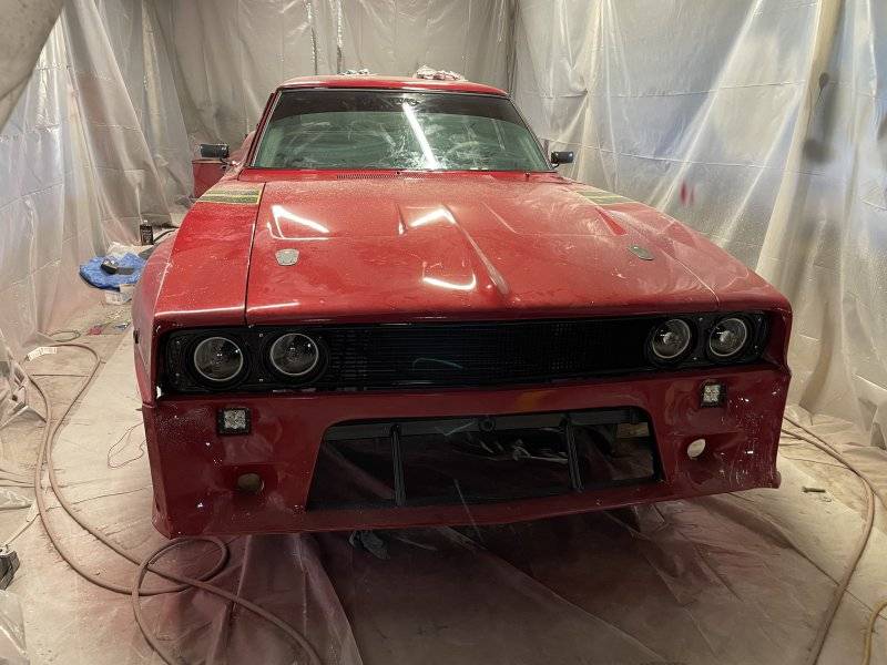

Thanks all! I snapped a few pics of its current state. The headers are hard to show since everything is crammed in there. The suspension and headers were strictly a function of the amount of real estate not available otherwise. The headers had to route to the drivers side since the passenger side is taken up by the front driveshaft and differential. The suspension had to be done because of the front cv shafts taking up space in between the control arms. In the rear I needed the push rods to fit between the frame rails and the wheel wells.
In the pictures, I’m still working a lot of polishing the paint so I have compound pretty much everywhere!!
I think I popped a blood vessel in my eyes trying to take in all that genius (or is it insanity?) but, but, but where's the wiper fluid reservoir?
