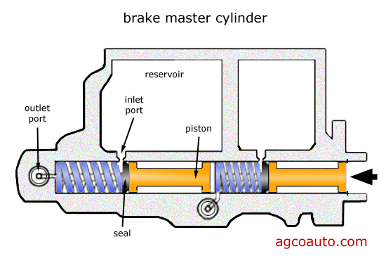

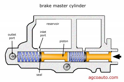

This will only happen when the master is not returning. When the master is fully returned, each piston has cleared the small hole that allows the brake fluid to go from reservoir to cylinder and back. If can go both ways to accommodate the expansion you are talking about. Take a look at this:
