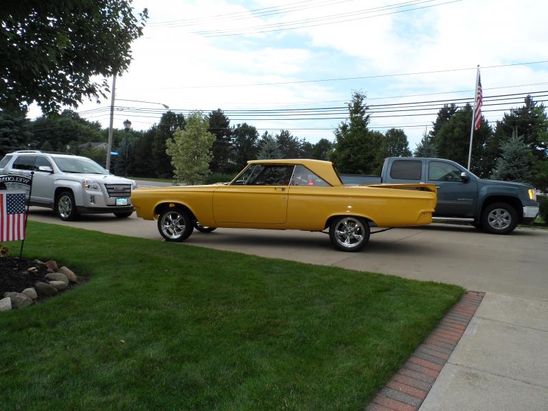

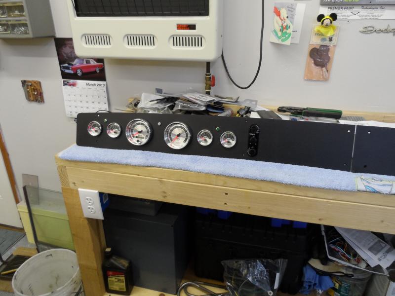

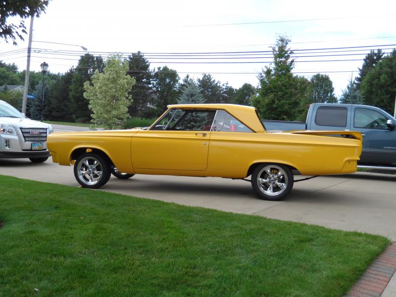

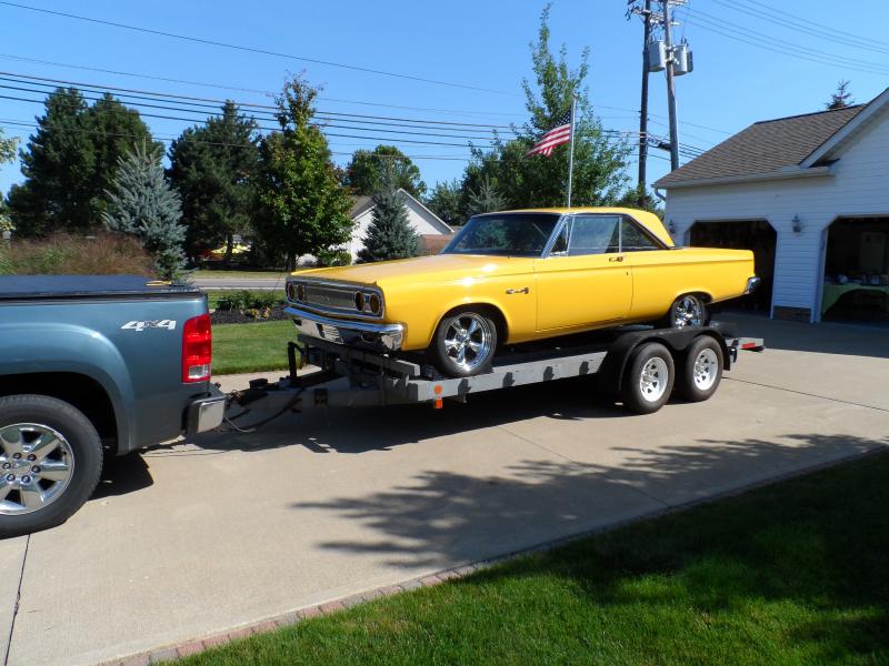

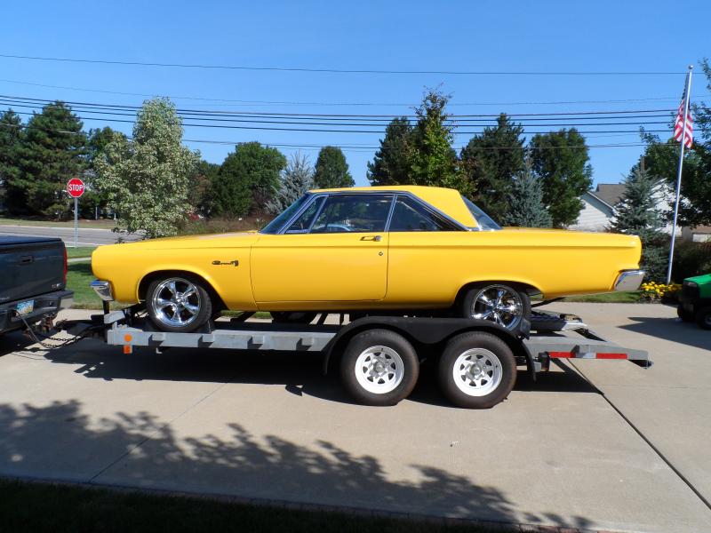

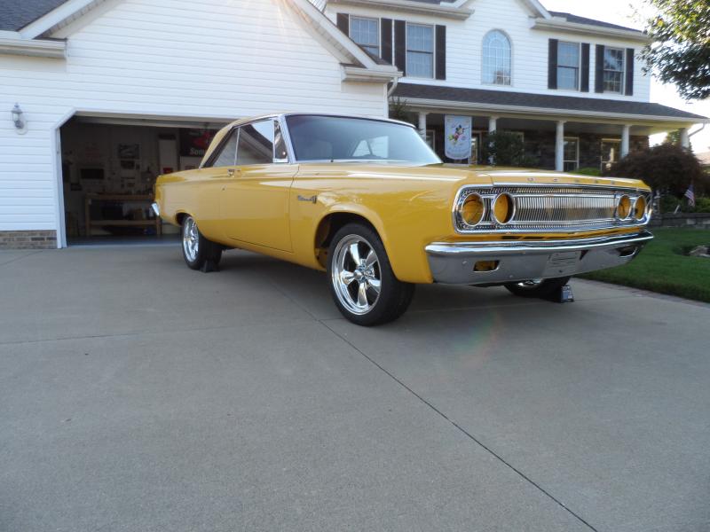

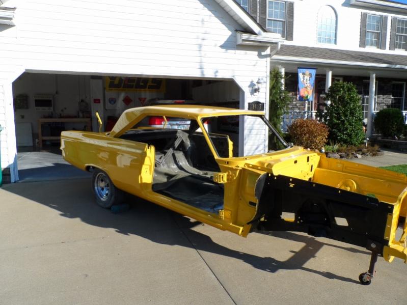

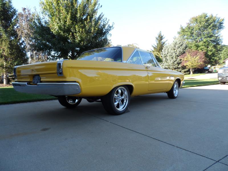

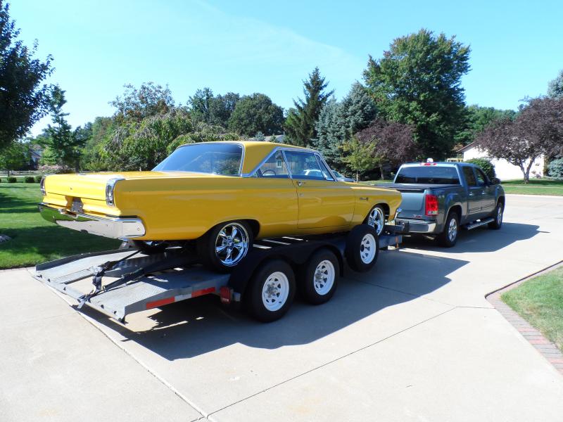

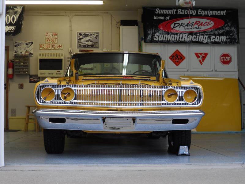

Thanks to zack 5.7 FOR PUSHING ME. here are some pictures of my 65 project SAM_0262.jpgSAM_0290.jpgSAM_0218.jpgSAM_0207.jpg2012-04-08_13-45-21_404.jpgDSC_1077.jpgSAM_0085.jpgSAM_0096 (800x600).jpg ALSO CALLED ARREST ME YELLOW MORE TO COME:icon_pidu:
Nice Coronet & welcome to FBBO

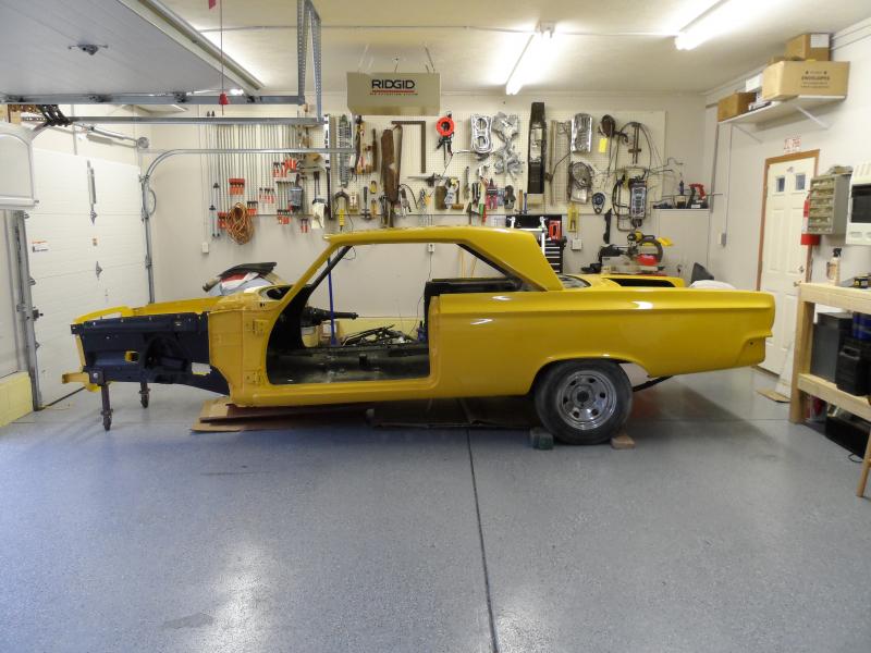

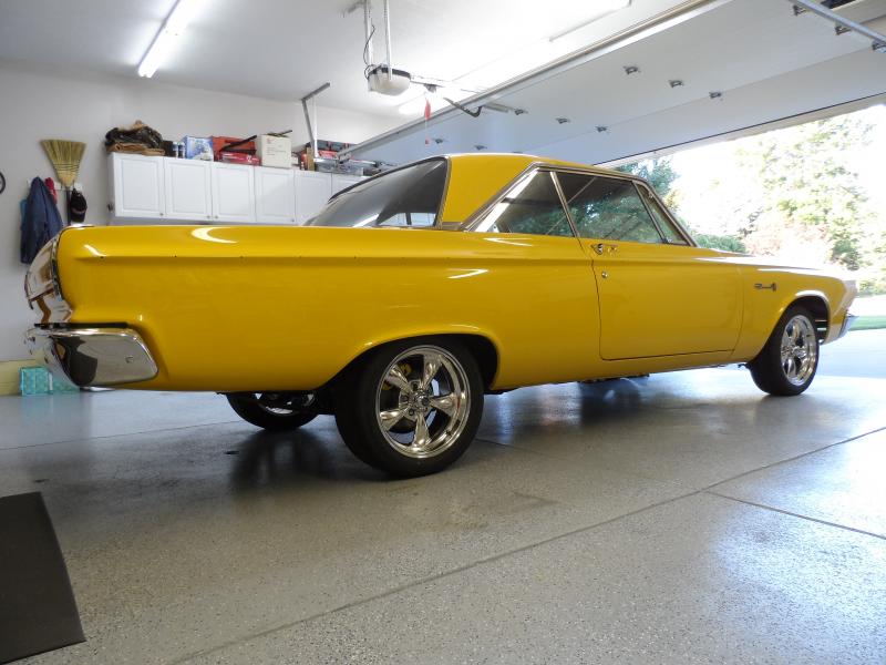

Rustoleum brand local Home Depot Half the garage has been done for 12 -13 yrs no issues other then real hot tires leave a mark.
hi and welcome to the site beautiful car and a very nice job glad to see another member from ohio :headbang:

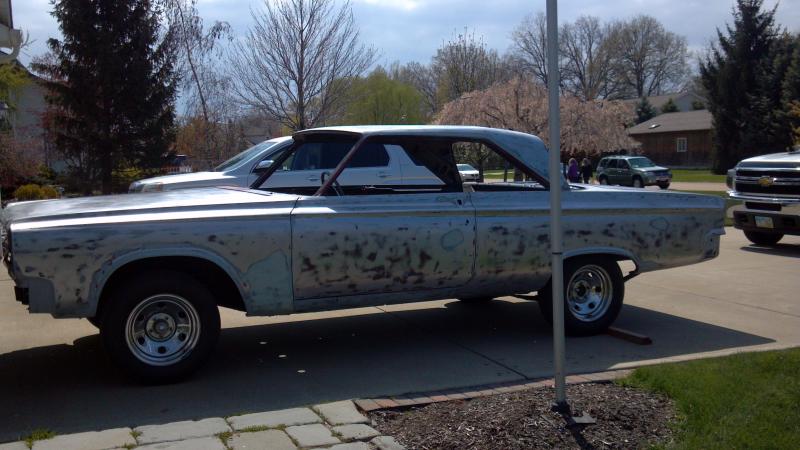

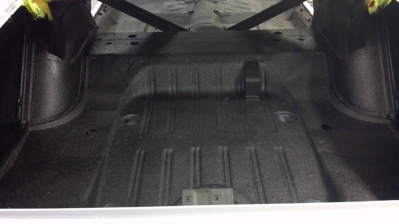

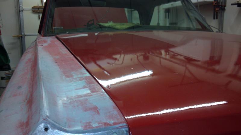

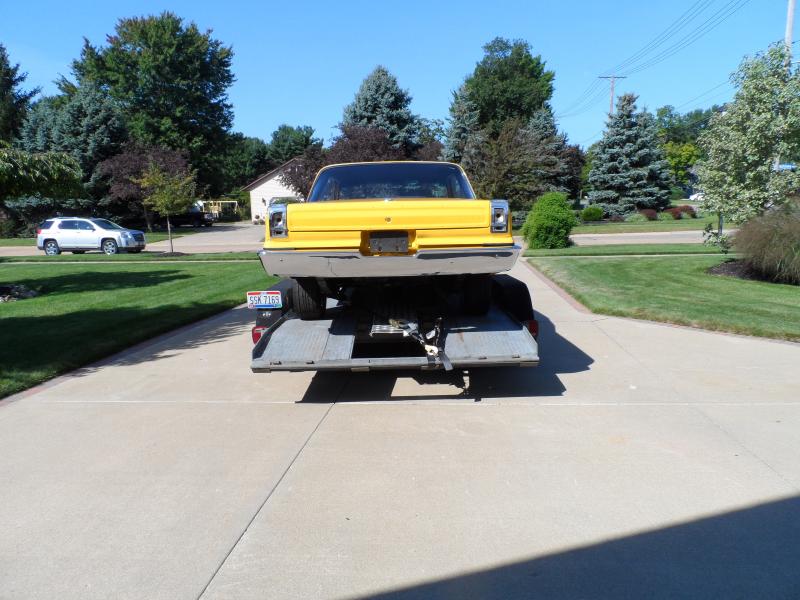

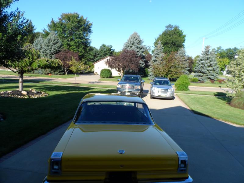

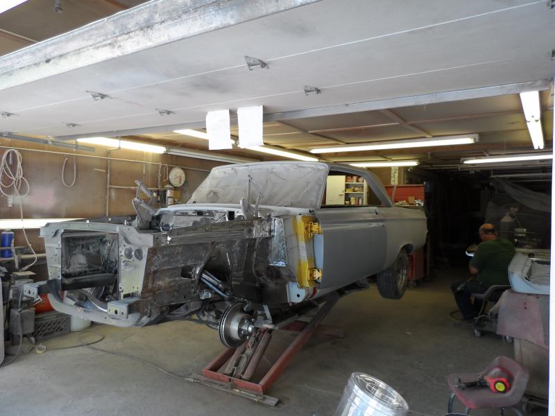

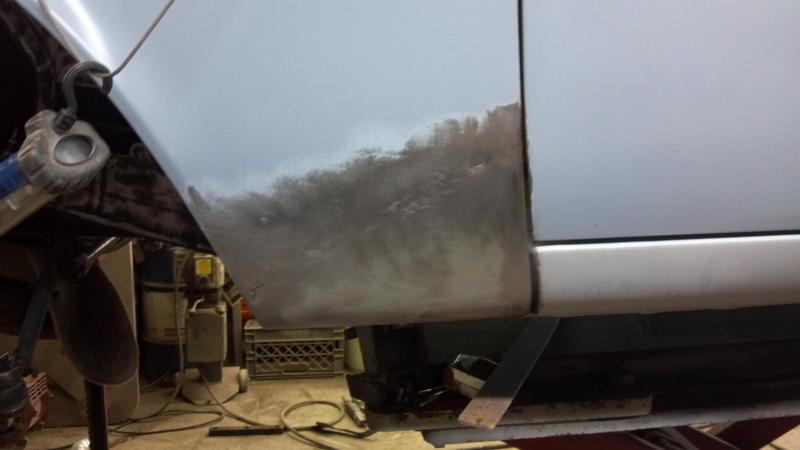

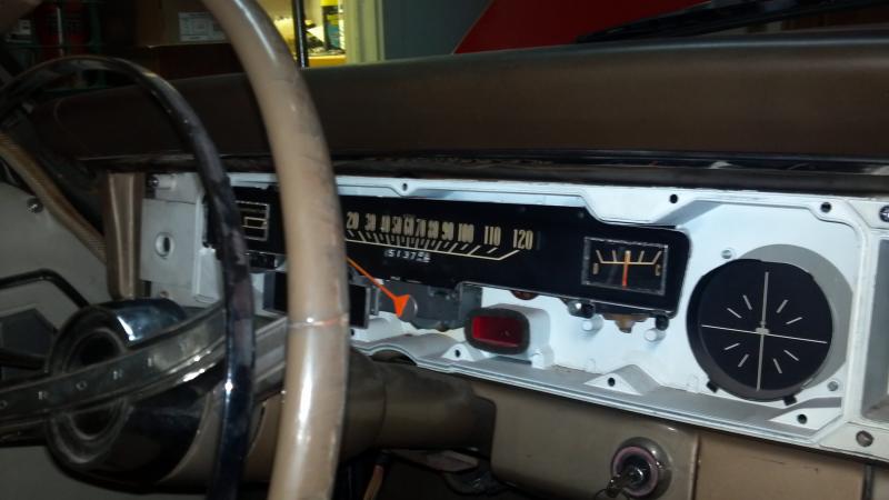

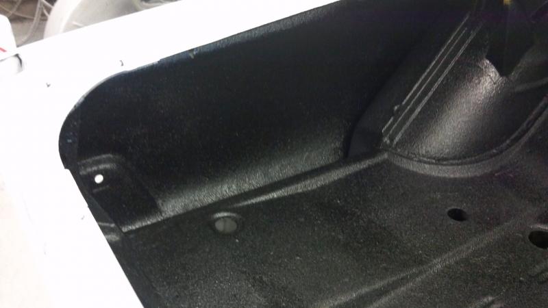

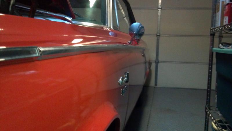

[/ATTACH]2012-01-02_16-34-29_943.jpg2011-11-16_17-18-11_297.jpg2012-10-12_16-36-53_363.jpg2012-10-12_16-37-00_446.jpg2011-11-16_17-19-01_868.jpg2012-08-12_09-30-29_573.jpg2012-08-12_09-30-35_602.jpg2012-10-12_16-37-43_742.jpg Some More pics no order the car was red when i received it however painted it never put catalist in the paint so it never dried under the clear. hand scraped the whole car with a 2" paint scraper,what fun
WoW..did you do a good job or what.WOW..that is super nice..great work buddy..keep em comin..God Bless..Barry.
Damn, that is a friggin' nice looking car! The coating in the trunk is nicely done. I had a feeling you would use what I told ya "arrest me yellow", lol! The grille matches the those bright *** bumpers very well.
Got any pics of the engine/trans combo, also what they are? How about the rear? Whatcha using gear wise? Come on man, enquiring minds want to know, lol!

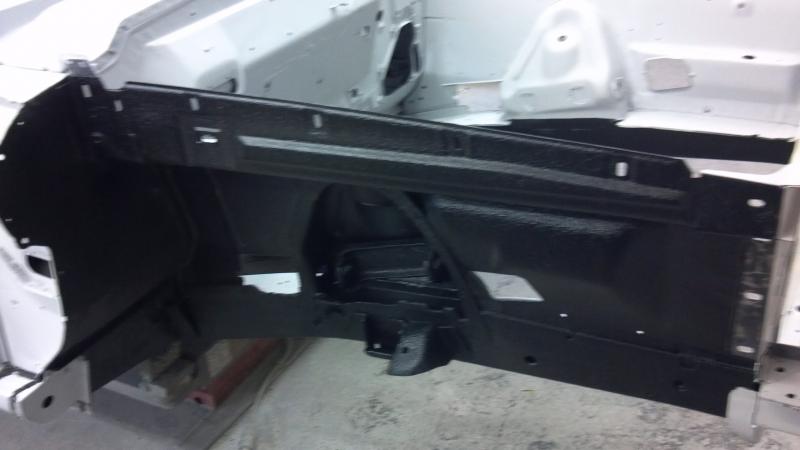

No pictures of motor and trans combo:angryfire: still waiting on the machine shop to finish machine work, it will be done in july myA@@. Anyway its going to be a 500ci stroker with a 67 ,727 b&m ratchet shifter , hyd roller Fast efi 2 fuel injection.Out back it has a 742 with a set of 3.55 with the posi lok , 4 wheel ssbc disc brake setup ,17 x 8 with dunlops on the front 17x9 on the rear with 555 nitto drag radials on the rear. Original 383 4bbl and cable shift trans still in garage all rebuilt for sombody else to enjoy. In the trunk inner fenders and whole underneath of the car was done with 2 part bedliner, the inside was done with 2 part lizard skin!
