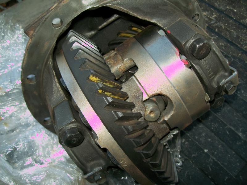

Then I went to the pick and pull and found a 72 B-body with a 8 3/4 diff. Yanked it out and brought it home. It has 2.76 gears, but the 408 stroker should handle that. Having some time available during the holiday, I started work on it. First came a new Power-lock clutch type posi. Made in China, I know, but they are available on E-bay. The oil looked fairly clean in the used diff, when I yanked the pumpkin, and sent it to a gear shop for install.
The 8 3/4 diff has 11 inch brakes, so it will be a brake upgrade as well. I started the Charger, when we had some warmer ( -2 here in Canada) weather, didn't even need a boost, and the electric choke was working. I drove it around the block and parked beside the garage, ready for the diff install.

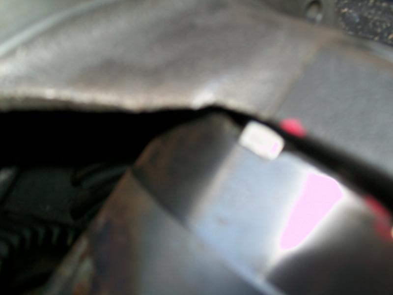

The gear shop ( they are also racers) called and said they can't install the posi without some grinding on the case. He says all the Chinese posi's are too wide and he has to clearance them. It takes longer, you have to remove the pinion and clean any grit out of the unit. dodge diff 002.jpg
The grinding was done just above the red mark, in a curve, and about 3/4 inch into the case. Not a lot, but still a PITA. The fluid in the diff was fairly clean, must have been changed. I am using synthetic fluid and posi additive.dodge diff 004.jpg

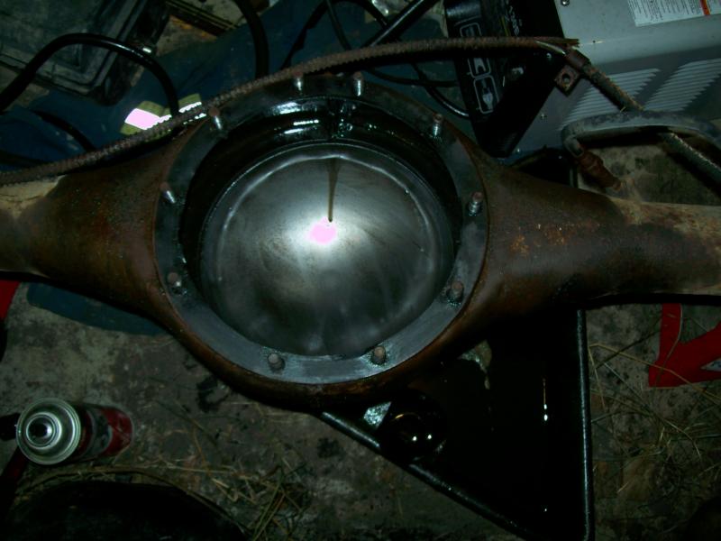

I cleaned out the old fluid

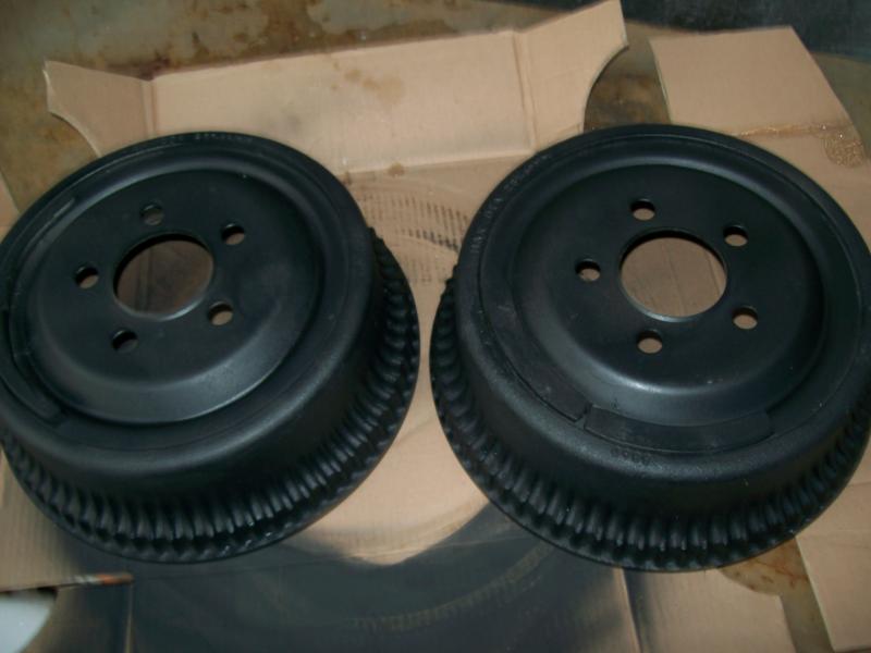

I am going to rebuild the brakes as well. The drums and pads were available locally. I had to order the spring and hardware kit on ebay from rehrenberg, a seller with a lot of NOS and USA made parts for these cars.dodge diff 006.jpg
