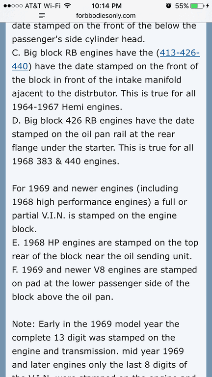

More good reading most of which supports my actual real world findings of the 68 hp motors I have along with cars.
http://www.forbbodiesonly.com/moparforum/threads/matching-numbers-defined.10596/
Excerpt
