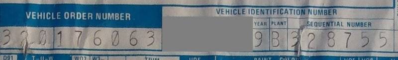

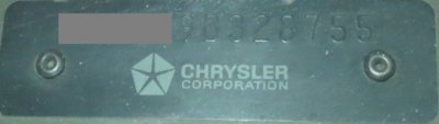

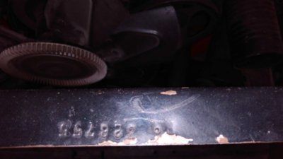

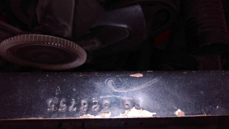

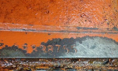

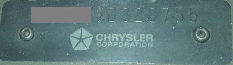

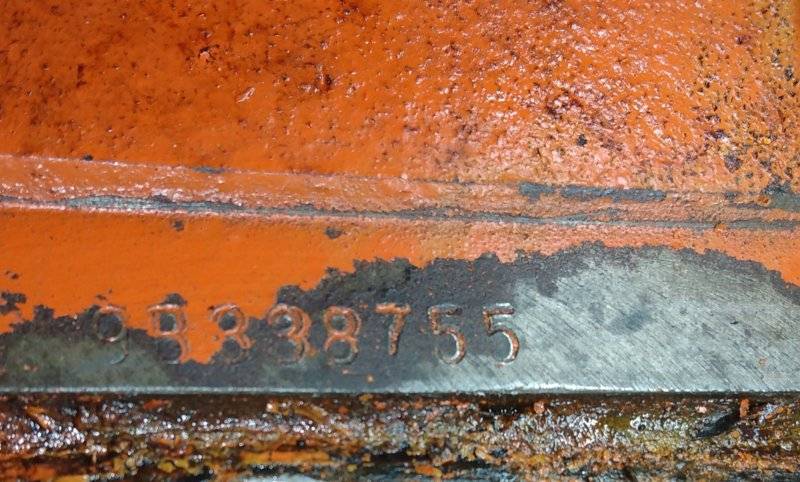

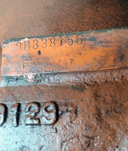

I have full images but wasn't sure if that was totally safe. Couldn't think of any problems but, these days... Also, I don't understand the "10k" reference from 69L48Z27. Hope these help. I'll put a pic of the car that I now know is the wrong color up here too.

What about the casting date on the block. If it lines up with the build date of the car then I would say it is an error. At 10,000 off the casting date should be nowhere close.
