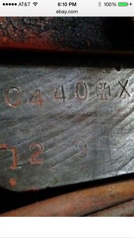

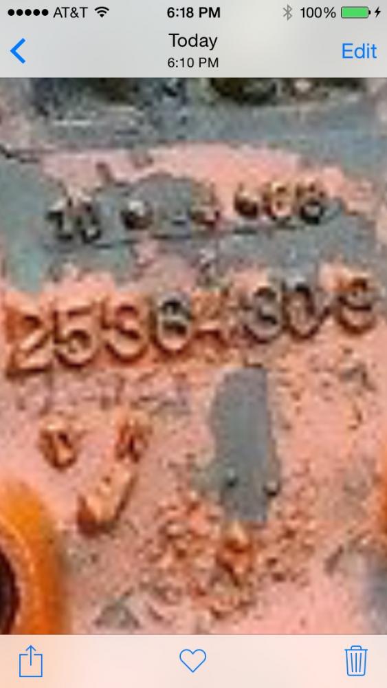

Can anyone help me translate these numbers. Thanks

C= 1967 model year
440= CID
Maltese X = .010 undersize crank
12 9 = engine assembly date of December 12 (1966)
no HP = came from a C body.
11 ? 66 = engine casting date of November ? 1966 which works well with an early December engine assembly date.
Engine casting number
