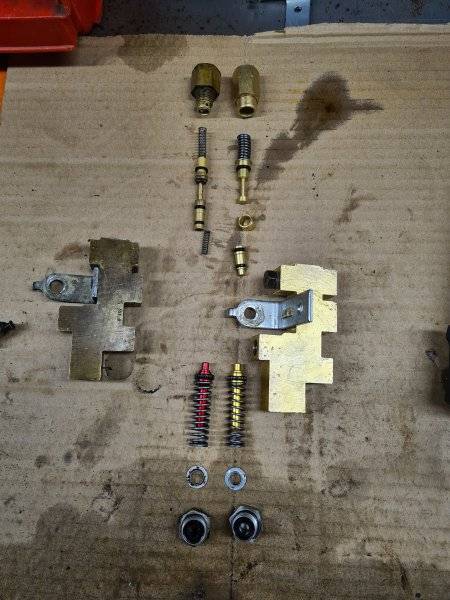

So i think i need to change som of the orings in my combination valve, does any of you know what size all of em is? It the one on the left in the picture
You need to measure what you have for the true answer.
Usually, O-rings are sized by: O.D. X I.D. X cross sectional thickness, in inches or decimal numbers. All are un-stretched dimensions. Any auto parts store will be able to match up. Elastomer coild be: Viton, epdf, PTFE (Teflon), Buna-N depending on temperature and pressures expected. Just my opinion of course....
BOB RENTON
You can buy a kit off Muscle Car Research at a very reasonable price.
It has all the seals, o rings and copper washers you need.
