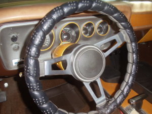

Re: 1972 Satellite Sebring Plus. I sent off my instruments to have the ammeter gauge converted to voltmeter (and general gauge restoration). Now I find the speedometer is nice and steady but reads too fast. The odometer evidently is right on the money, so changing the speedo pinion gear won't correct things (anyway, the drivetrain is all original so no reason to have to mess with the speedo pinion). Must be a fix out there somewhere, right? Thank you.
