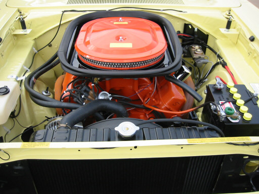

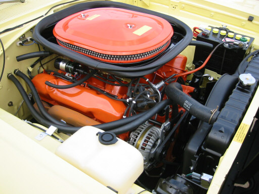

Did the 69 440's come with black wires or orange wires from the factory?
flat black wires boots at the distributor were black and boots at the plug were red, I think :p
plug wires were black, plug boots were orange and distributor boots were black.

wires
Great, thanks. I was told they were all orange and I brought a set, now I have to find the right ones.
