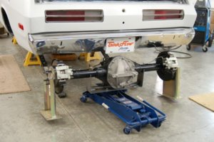

I have a S60 rearend from DoctorDiff in my Duster. It is 45 inches wide with 35 spline axles, a Detroit Locker, 4.56 gears, Torino ends and Explorer disc brakes. Super nice setup.
