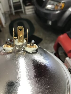

Please explain what you mean by "the tabs". Is this on the terminals as pictured? Just curious as to what the problem is. I know that 6014 was the industry number for many years for the single seal beams. I'm not familiar with 6024.. (And now all my old Mopar cars have the 4 headlights system.)
Yes, so each terminal now has a tab, for lack of better terms, sticking out on each post. They limit how far you can insert the terminals onto the socket. You can push the tabs in, but still can't get the terminals all the way into the socket.

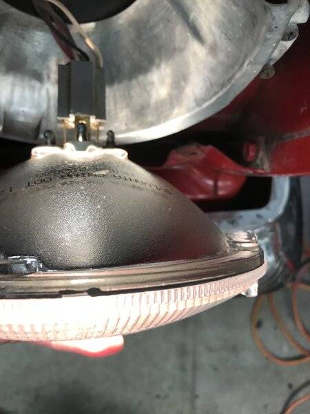

The pic shows just how far the terminals will go into the sockets.
I wouldn't change the OEM plugs on the harness. Why not cut / file off the offending tabs on the bulb bayonets? Or can you just bend the tab back flush with the bayonet?
Yeah, I tried that with one of the bulbs. They still wouldn't go back any further. Probably need to file down the terminal sides too.

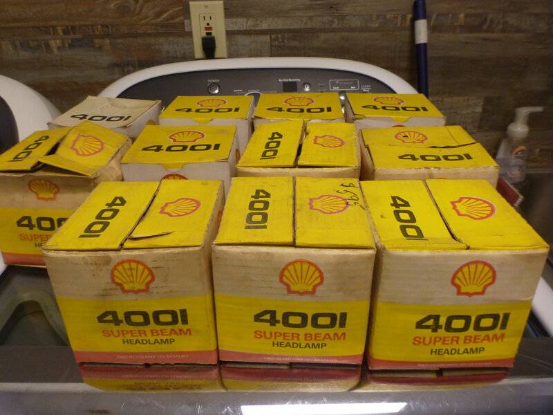

Like I said yesterday in a PM, post a WTB for some old stock bulbs or browse Facebook Marketplace etc. Where I got all those old 4001's and I only had to drive 6 blocks across our little one horse town.

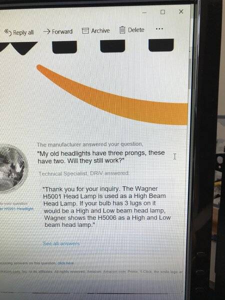

So yesterday, I posted this question on Amazon for the Wagner H5006 bulb. This is the reply I received.

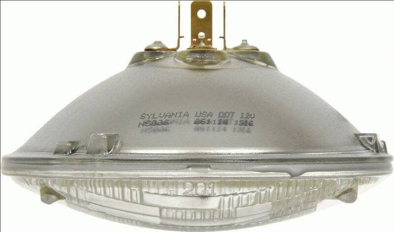

H5006 are for 4 BEAMS setup ( small diameter ) if you are searching for your 66 they won't work because your ones are the big ones. I just posted that pic as an example of how they get the same tab, but seems to be smaller because their terminals fit diff ( higher ) than the 6024s you got.
all 6024s available at this moment are with the longer prong attaching lower into the sealed beam terminal, but the socket will reach the same point not just because the tab, but the deepness of the female socket. Wagners gets a protective housing which will make them look better thought
Both Wagners are avaiable halogens, so better get a relay upgrade for them
