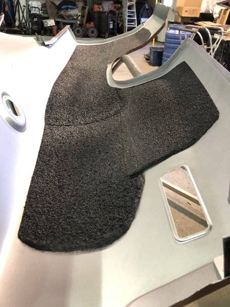

You can get good results. with over the counter rockergard, it mostly comes down to technique. These are a set of n.o.s 70 charger quarters I sound deadened for a customer. And yes it’s generally a very messy process to apply
Chargerfreak, can you message me please. I'd like to fine out more about your process.Thanks! Also, what exactly is this product you are using?
